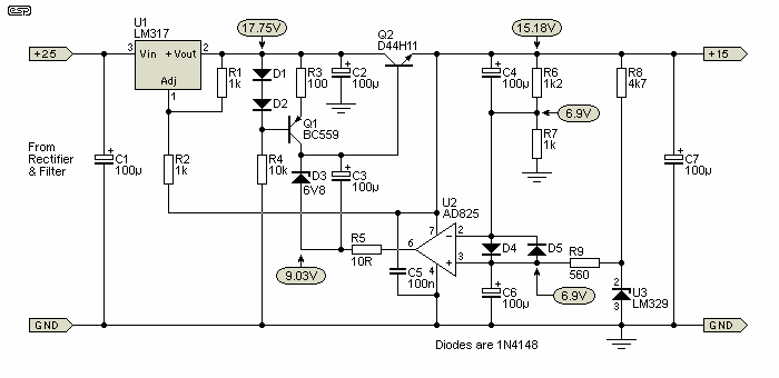

I have been building small power supplies using the 317 since they first appeared in the UK ,there have a better performance than the fixed regulators .
I could not figure out what the OP was aiming at and now he has said -quote --I will be using a Studer 900 , it would have been more logical to say that in the first place.
Yes I agree with your circuit that's the type of power supply I am used to very easy to build and cheap at the same time , that's what this website is all about ----DIY .

TI has a new version of the LM317 Amplitude.
Noise floor is = 38 uv rms
Does your Studer 900 go lower Mr. HifiTunes ?
LM317 data sheet, product information and support | TI.com

Some get around 2,5uV
\With a modified bord :
quote :
I did some simulation before, it didn't quite match your measured data. The feedback loop of error op did generate noise chart similar to your graph, but the peak value & frequency is very different. and it do move around with load.
load........peak.freq...peak
10mA.........4.4k.......316nV
50mA.........7.5k.......637nV
100mA.......8.8k.......433nV
500mA.......8.5k.......670nV
1A..............6.6k.......337nV
It dose not appear at no load though, and if change 220p compensation cap to 9n.
10mA.........750........180nV
100mA......1.43k......3300nV
1A.............1.08k.......190nV
