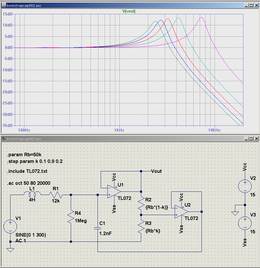

I was just thinking about how to use the second 20k pot, for some tone adjustment. Rather than just load down the output with a basic treble-dulling circuit based on 20k, a more interesting effect might be to get the effect of sweeping that parallel cap value discussed above. Ie, the typical peak and fall of a passive pickup driving a cable gets swept from say 6khz down to say 1khz, or switched off. Ive got an idea for how to do that, needs a couple more transistors.
...sweeping that parallel cap value discussed above.
The easy way is to bootstrap the other end of the capacitor with a voltage that's in phase with the input, but adjustable in amplitude, up to nearly equal to the input voltage. Varying the amount of bootstrap varies the apparent capacitance. It works just like Miller capacitance, but the in-phase voltage reduces the effective input capacitance rather than increasing it.
I threw together a quick LTSpice simulation to show how it works. V1 / L1 / R1 represents the guitar pickup. The first op-amp buffers the pickup, R2/R3 is a linear pot that controls input capacitance, and the second op-amp bootstraps the input cap (C1) with the voltage from the pot.
I used a dual op-amp, but it can also be done with a JFET in place of the input op-amp, and a BJT emitter-follower replacing the second (bootstrap) op-amp.
-Gnobuddy

Yep, that's what I was thinking too. An opamp version is probably the way to go, with a pure performance and very few parts. How much current would a dual opamp need?

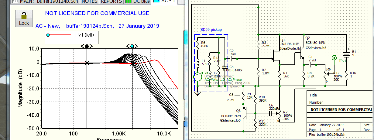

But I have an all discreet version spiced up, just because I like them. It reminds me of tinkering with transistors in the '70's, when I was supposed to be doing high-school homework. Ill post it later.
I also reckon opamps are easier, and purer, but here is my discreet transistor version, FWIW:
It's based around the jfet buffer, with a couple of bjt's to lower output resistance for feeding the 20k pots and making sure the capacitance feeding back to the pickup is done via a low impedance.
But it looks like it would work, and draws 1.1mA in theory, and can produce a clean output swing on +/-3V.
btw, the pickup is modelled with 6 components. This is a whole different story but it is tuned to very closely match the output and impedance of specific tested pickups, in this case an Seymour Duncan '59 humbucker. These models have been developed at Guitarnuts2, for several dozen types, based on very detailed measurement by others there.
If I'd use opamps, I'd opt for the TL062, which is a low current dual opamp that drains the battery by only a few mA.
