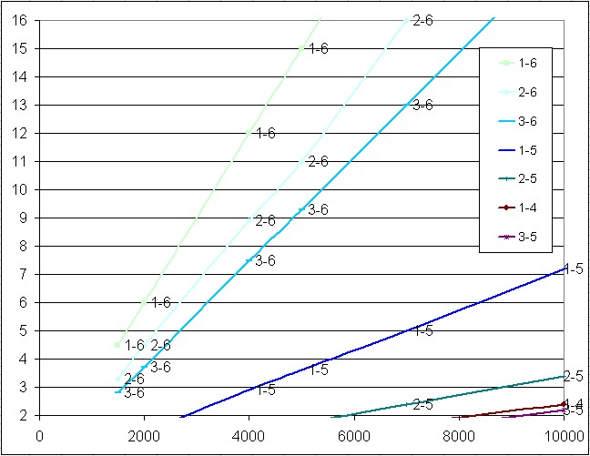

I've got a Stancor A-3849 universal 10w single ended output transformer here. The box alleges 1k-10k impedance.
I have the instruction sheet, but i can't make any sense of how to use it?
Plate and B+ terminals are clearly marked on one side, and there are six terminals on the other. I understand the concept that the impedance is set by which secondary terminals get hooked up to the speaker - but I don't understand how to apply that concept based on the matrix presented by the manufacturer.
Here's a picture of the sheet. Apologies that i haven't managed to slap it on a scanner yet to get a clearer image:

As an example, 2000 ohms primary impedance is formed when 6 ohms load is connected between lugs 1 and 6.
Obvious 4000 ohms primary impedance is formed is the lugs are same and secondary load is doubled to 12 ohms. Etc.

To see it from another side (actually means the same) , a transformer does not "have an impedance" by itself, but converts/translates a speaker impedance into a higher impedance seen by the plate.
What they actually offer is a fixed primary, and a tapped secondary with 6 taps, which offer different *voltage* ratios and *impedance* ratios.
They might very well just print the voltage ratios and let you do the Math, or print just a couple values.
They were incredibly honest (or suffer OCD 😉 ) and offered a full table covering all possibilities, even the most impractical ones , such as .09 ohms or 0.43 or 21 ohms 🙂

As for being complete, the box advertises 1k to 10k, but the table only goes to 7k. So it might be nice if they stated the ratios.
I had no idea that sub-ohm voice coil impedances were a common thing at any point? Certainly not in the distant past - I know car audio guys like low-Z speakers.
You can double the figures in the 5000 column to get 10000. Or type into excel and extrapolate with a ruler. Or add the 10000 column in excel. Some of the possible connections are off the chart literally and so to speak.
