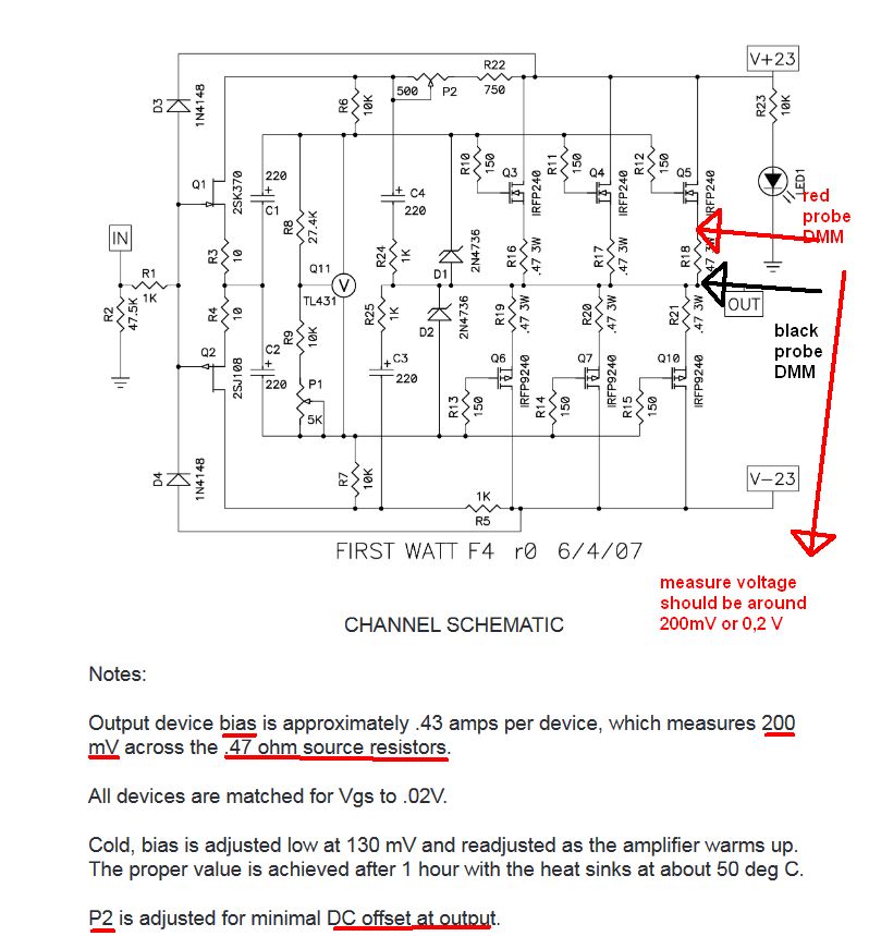

Ciao @JSA1971 I don't know what's wrong with mine, my suspect is the bias is not correct as I mentioned above the brick never gets any warm, true that the room is colder than outside (...) but still my guess is it doesn't even reach 40C with an ambient temp of 27-28C and even back then end of summer when here gets really warm it never gets to any uncomfortable degree of heat when touching it.Giovanni, I’m a little surprised that you’re finding the 25w/channel is not enough (assuming that the bias and actual 25w per channel is being output) for your L220’s. I’m currently running my L150’s (88db sensitivity) with my Aleph J in a room 14’Wx22’Lx8’H and it is plenty loud for me. I’ve also powered them with an M2 and was again impressed with how they handled the 150’s.
I will review the constructions notes to find out how to measure the bias and if that can be done with one multimeter I will try and check it just for the sake of it, maybe adjusting would bring more juice to the speakers.
Grazie
Hello Giovanni,
you can measure this yourself with a normal DMM (digital multi meter). Set your DMM to V.
Put the red probe of DMM to one leg of a bias resistor and the black probe to the other end / leg of this bias resistor.
Now measure the voltage - you should get a value of circa 0,2 V (=200mV) over one of the bias resistors.
Work slowly and careful! Be careful that no probe of the DMM is slipping uncontrolled into the amp switched on!
Don't touch the transformer and the AC-input during this 'operation'.
Cheers
Dirk

You can measure over bias resistors R16 / R17 7 R18 - write down the voltages and post them here.
Also measure over the bias resitors R19 / R20 / R21 - write them down and post here.
Then we can see / calculate, if your F4 is biased correctly.
DC-offset is measured at the speakeroutput (without any speaker connected!). Red probe DMM to + speaker out,
black probe of DMM to - speaker out. Measure in Volts (or mV).
Cheers
Dirk

Grazie @cubicincher so I just power it up, let it warm for an hour or so, no input signal, no load on the output and take the measurements, is that correct?
I will have to find out the resistors on the boards (they kept telling me for ages "ohhh, yeah, you'll see, all of a sudden your sight will drop..." it did happen even tho way later than they all predicted but, damn, viewing glasses!) and check it all out, maybe tomorrow while I bake the lasagna I assembled today, you know, here in the Vesuvio bay Sunday is mangia mangia day ;-)
Grazie ancora
edit: bottom of this the procedure seems pretty straightforward even for a nerd like me
Grazie ancora
