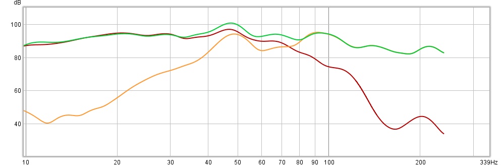

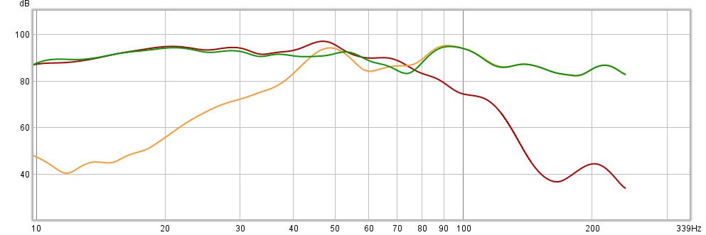

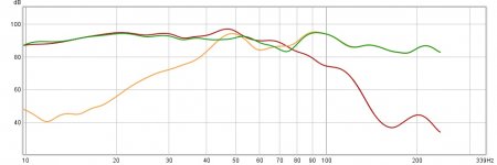

Same as above for me, but I only done it between the mains and sub. I applied a time delay by ear to get roughly in the correct region, then started measuring. I took about 30 measurements, in 0.1ms increments.
Before and after response attached. Red is sub. Orange is Mains, Green is total.
Before graph shows almost totally out of phase, lots of destructive summation
After response shows my best attempt down to the closest 0.1ms at constructive summation. Sounds much better now this is corrected.
Thanks to this link - DIY Speakers and Subs - AVS Forum | Home Theater Discussions And Reviews
