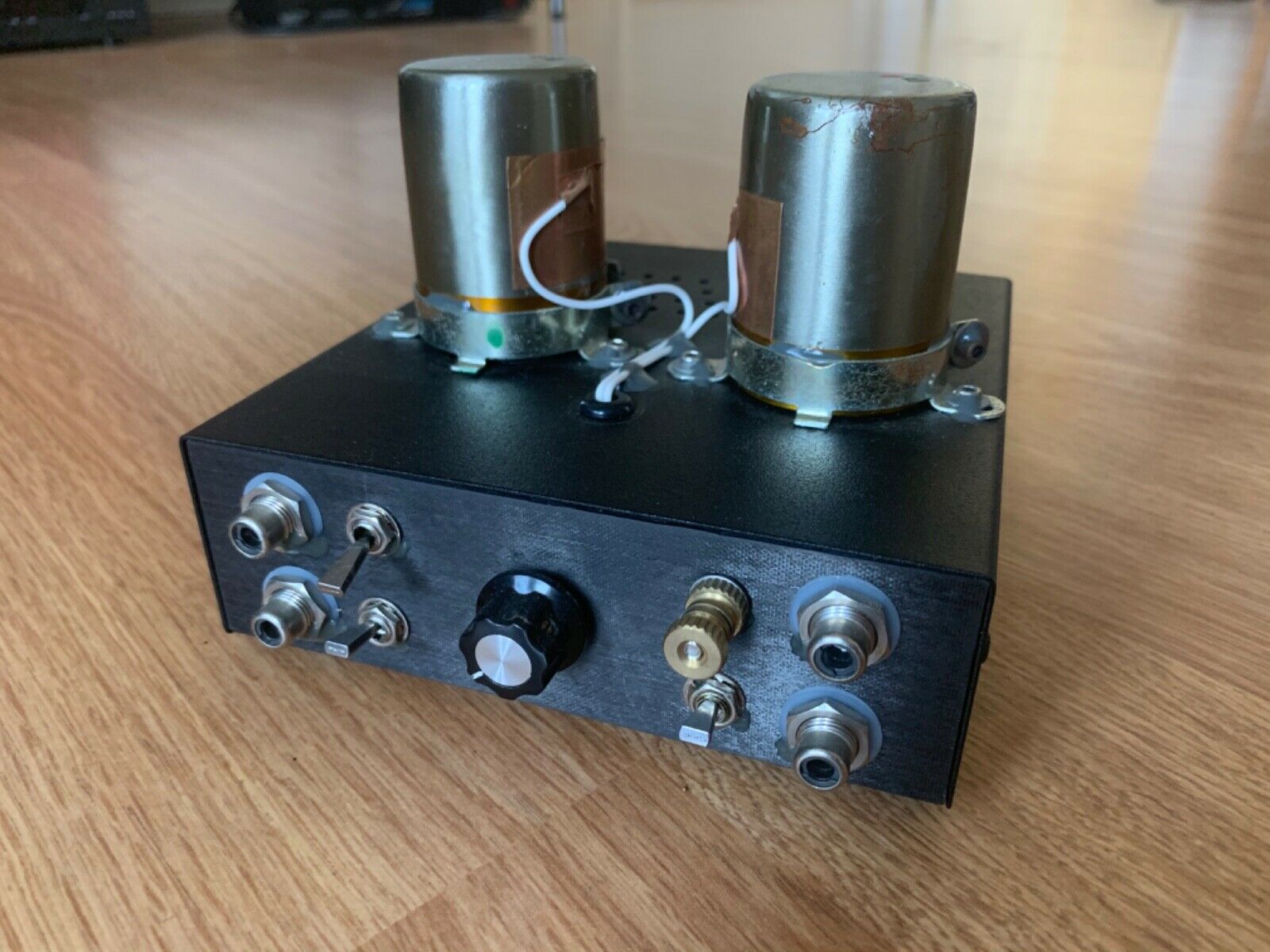

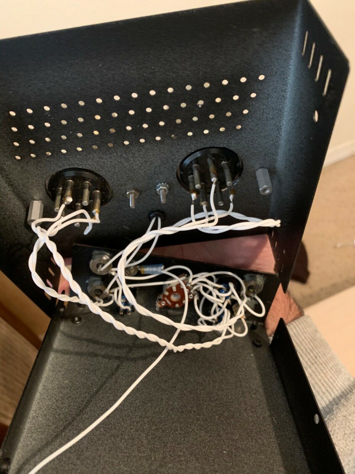

Just out of curiosity I'm buying a phono step-up transformer...not just the individual SUTs themselves but the whole box with 2 transformers, RCA ins and outs, a couple of switches, already all wired up, etc.
The thing is that there's basically no information about it and so far based on pictures (I don't have it in my possession yet) there does not appear to be identifying info about the actual SUTs which are tall metal cylinders (or maybe encased in tall metal cylinders.) In the pics they look to be about 1.5"-2" tall without including the pins.
If I can't find any info on the body of the parts, how can I test the SUT to figure out the specs of the thing such as the ratio?
In the pics I've seen, each transformer has seven pins (guessing pins are about 1/2"-3/4" long and there are wires connected to four of the seven.
Any help much appreciated!

Any info about the manufacturer? If this is a DIY product, can you ask the seller or the person who made it? What are the switches used for? Please attach pictures from its outside front/rear and its internals once you got it.
Pics of the step-up transformer assembly

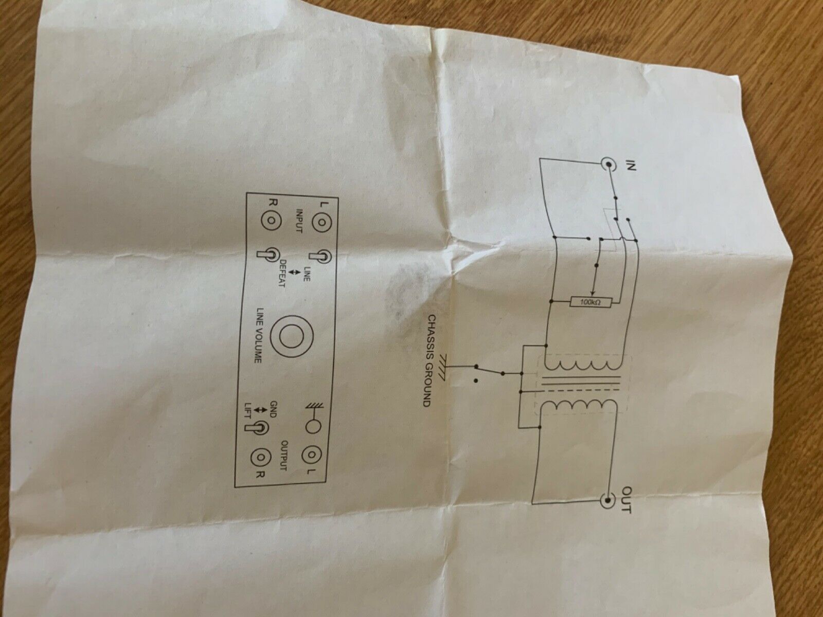

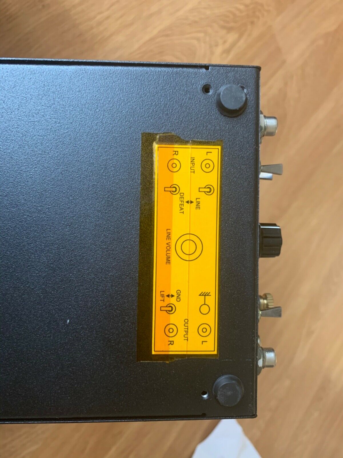

Not sure if my prior effort to post pics of this thing worked so I'm posting pics as attachments here.

To my mind that circuit has more of a look of a line buffer than a phono level SUT, after all who'd put a volume pot on a SUT for a phono application? Whether it's 1:1 or some other ratio of course remains to be tested.
