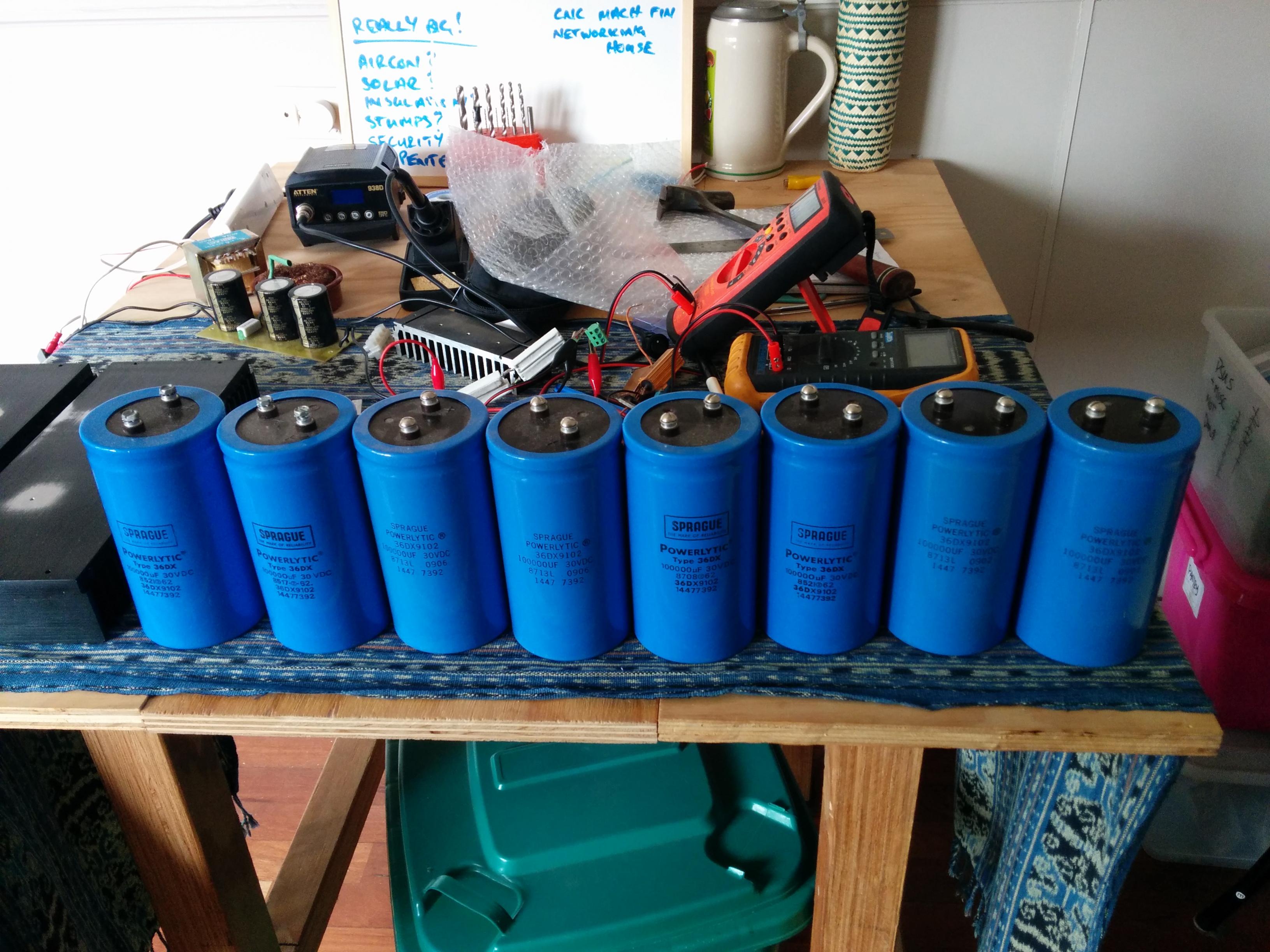

And all good. The best of them had about .15V across the 28K resistor feeding the +ve terminal, so I make that to be roughly not very much in terms of leakage current. So all good there; thank you for the assistance!

Voltage across the cap? It would have been ~29.5V generally across the group.
Have I misunderstood the process? As I measured it I had way less than 1 mA flowing into the cap, hence the leakage must equal that amount. Or have I misconstrued?
