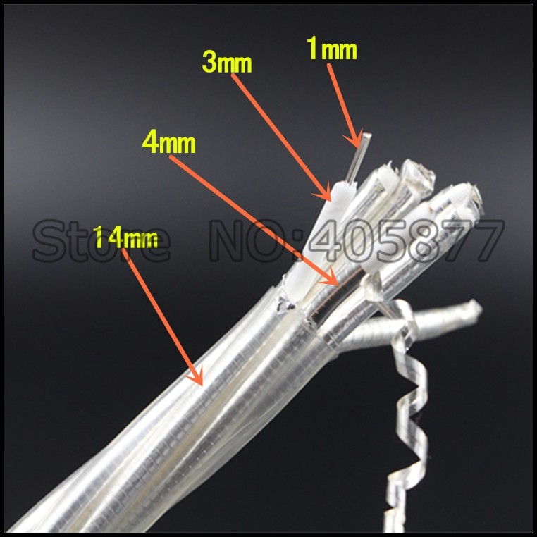

Why would you use this unless you got it for free?
You are dealing with mains wiring here, even if it is an appliance supply cord.
This must comply to Australian Standards.
No two ways around it.
The Earth cable is of prime concern.
The size of Earth and Active conductors is also of serious concern.
1. The colour of insulation of this Earth conductor MUST be either Green/Yellow or Green ONLY.
Use of any other colour is NOT COMPLIANT.
Note: Due to some types of industrial grade insulation the colour is limited and Yellow is permitted. The use of colour Yellow was changed to White for Active phase ID prior to my commencement of apprenticeship as an Electrical Fitter / Mechanic back in 1977.
2. The use of Green / Yellow for anything other than an Earth conductor is PROHIBITED.
Note: You find idiots using heatshrink over Earth conductors on 3 core cables as a switched active sometimes - ILLEGAL
3. The size [cross sectional area] of the Earth conductor should not be less than any Active or Neutral conductor in flexible appliance cable like this.
Note: Earth conductor in mains cables with Active larger than 2.5 sq mm [4, 6, 10, 15, 25, 35, 50, 70, 95, 120, 150 sq mm and larger] starts to reduce in size.
4. Aside of the NON COMPLIANT Earth ID in this cable pictured, the insulation voltage rating MUST COMPLY to Australian Standards.
It was .6/1kV for many years but this has been lowered to 600V.
Cable made for 'extra low voltage [ i.e.<32V ] automotive use does NOT comply to this .6/1kV rating.
Note: Now lower Standard of 600V has created issues for Solar Panel installers due to typical output voltages exceeding 1000V DC in even small scale array installations. So, installers have to buy special cable simply due to penny pinching argument over cheap plastic thickness on the damn wire lowering the Standard.
Economic rationalisation gone mad.
5. Australian and New Zealand wiring rules dictate all Fixed [wiring in walls] and Flex cables MUST comply to Australian Standards.
If you really want to upgrade supply cables to audio equipment due to some perceived lacking in current capacity consider this:
Your outlet supply is possibly somewhere between 230 - 250 V AC.
A flexible cable with 1 sq mm conductors will carry 10A safe even if 3metre long. That is a 2300 to 2500 Watt load.
Whats the size of that Amp your connecting with that tiny 1 sq mm cable?
Your extension cable is maybe 1 - 1.5 sq mm conductor... a long decent 15A lead will be 2.5 sq mm.
I've used 6 sq mm flex cable in Industrial applications.
In W.A. I've data logged 254V overnight in a rural backwater subject to daytime industrial loading that draws supply voltage down to 230V... a consequence of no auto tap change gear on high voltage substations to maintain close supply tolerance.
Here in S.E Melbourne tonight I see 242V.... was 246V testing transformer recently.
As far as 'shielded' A.C. flex supply cables goes, the 'screen or shield' is more often intended for mechanical protection than RF screening, however I have encountered cables on microprocessor based control equipment used in the power generation/distribution/protection and military sectors where supply integrity is of far higher relevance than a consumer market audio equipment.
Sorry, I don't wish to suggest deal with here is of the 'pissant' rating, but the cable you have there has NO merit in any application you could ever encounter in a home.
Perhaps maybe... just maybe, it would be of relevance in a commercial application, but more so in an industrial sector, and even so only of very limited application demand due to cost.
There should be a Law limiting retailers flogging the equivalent of audio 'snake oil' like this, especially when it is not compliant for use like mains wiring.
Ok, so based on what PRR has commented, how about L=2, N=2, PE=3? as always, safety considerations come first.

Such cable looks like it is made for a very specific use, and I suspect it's being sold 'off prescription'.
Silver plated copper is common in aviation and Naval installations. If thats PTFE insulation it's most certainly aviation.
