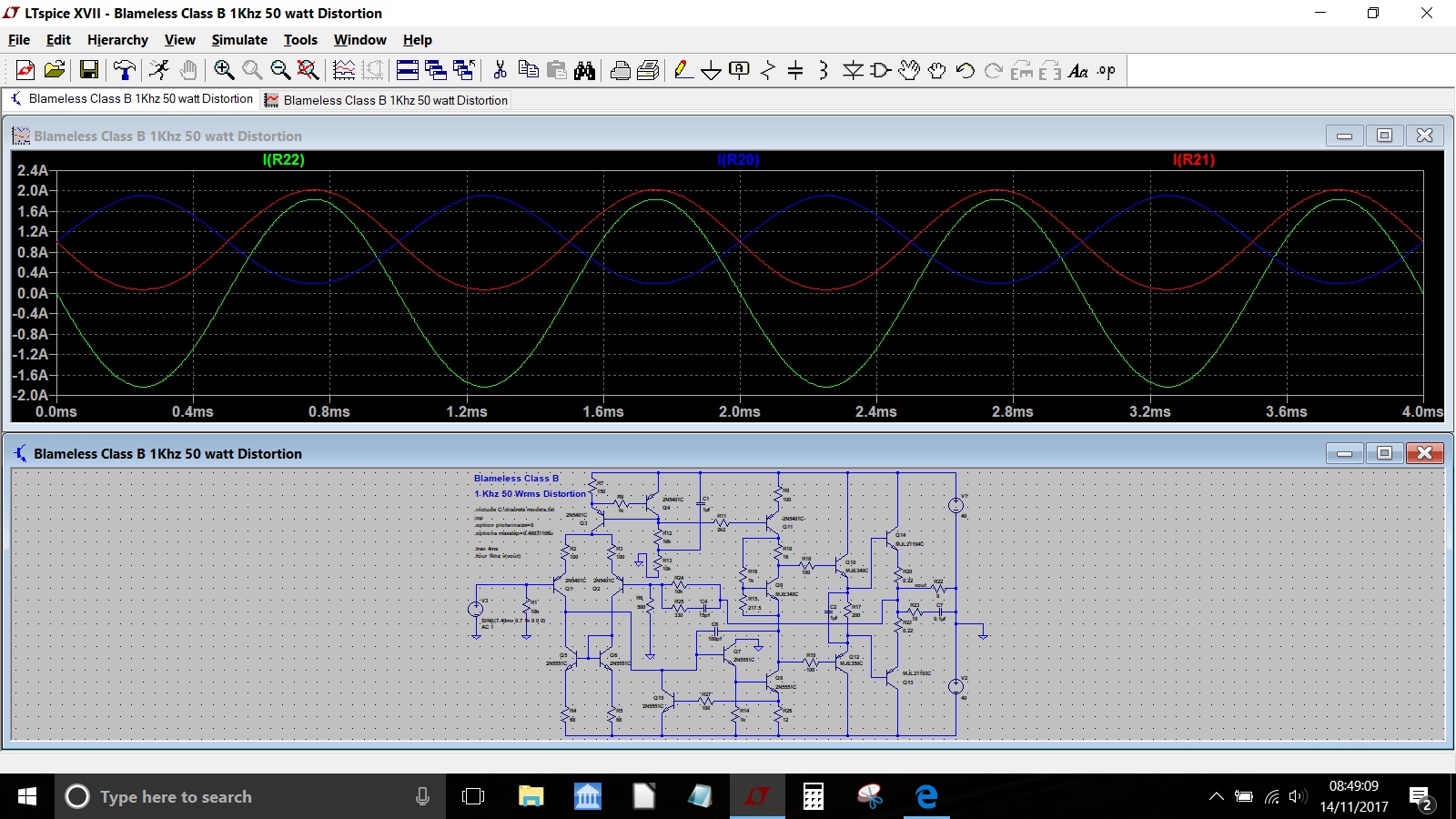

This is the classic 'blameless' amplifier set up with 1 Amp bias current flowing.
The first image shows an applied input voltage that develops a load current (in the 8 ohm load R22) of -/+ 2 amps. You can also see the currents in the two emitter resistors R20 and R21. These are still a sine wave and have an amplitude varying from 0 to 2 amps.
(Remember we said the amp would be in class A up to twice the bias current setting)

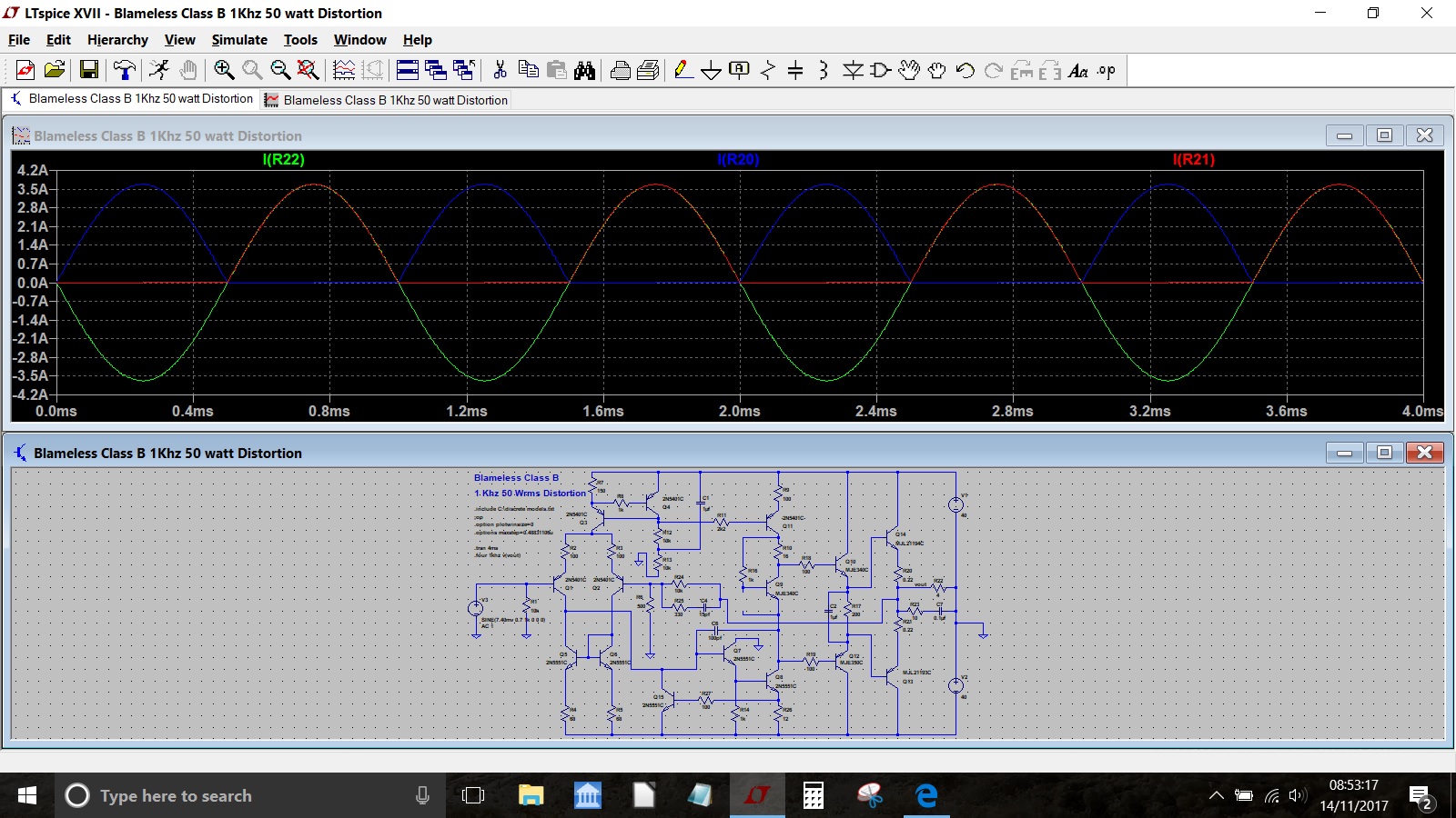

Now we change the load to 4 ohms which means twice the current will flow in the load. Notice now how each transistor now gets cut off as its current approaches zero, and consequently how the currents become a distorted waveform. The load current is still 'pure' but the amp has slipped into class AB as the bias current is now not sufficient to support class A operation into this impedance and at these levels.

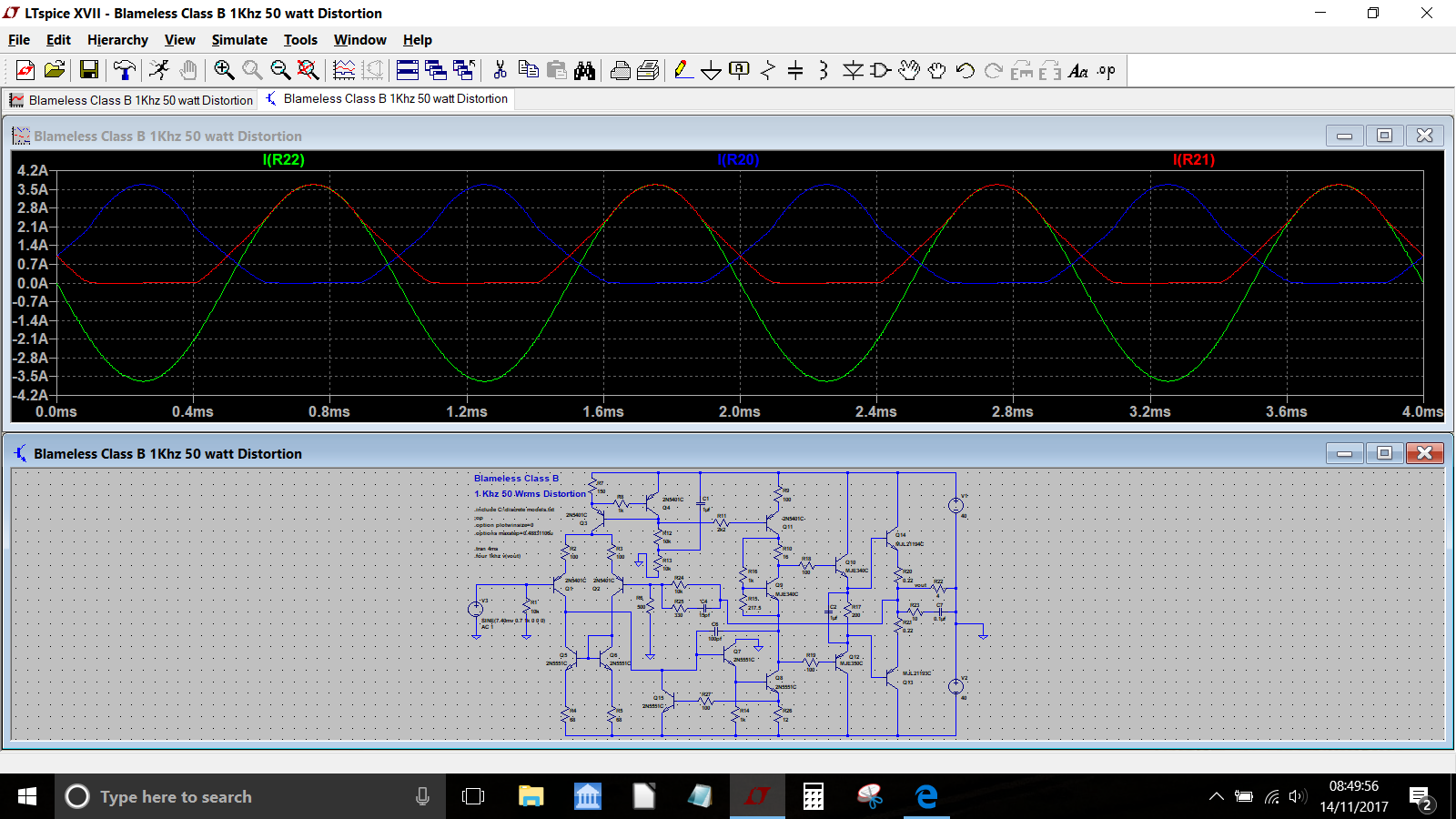

In the final image the bias current is zero, pure class B. There is no 'overlap' in conduction of the output transistors, each supplies and conducts for just 180 degrees of the cycle. The distortion is still surprisingly low at around just 0.02% THD.
