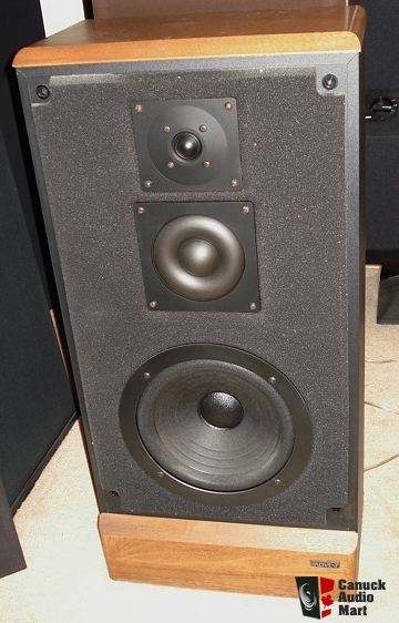

Do like Advent did with my floorstanding Maestro speakers....
A 1/2 inch layer of foam across the whole face of the front baffle - tames any reflections nicely.
No need for any of that sillyness and obsessive plundering.
