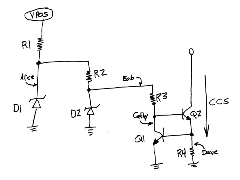

Hello,
I'm not sure where to post this but hopefully should be simple to answer. I'm going to use this CCS on tube cathodes. It will be referenced to a negative supply since there isn't enough voltage from cathodes to ground. It also requires a positive supply to bias the zener and this will come from B+ since it's the only available. I have a couple of questions about this. First, do all these supplies need to be super clean? It would be handy to get them from early stage of filtering and there will be a few volts of ripple. I'm thinking that it should work but is it optimal? Especially for the B+ there is a very convenient point to tap at the heaters DC elevation, the usual voltage divider bypassed with a cap. Would this work? The second question is if there is any problem from that all these supplies are used in different stages of the amp and none on the tubes where the CCS is attached. All of them are referenced at the same ground though.

🙂 I think I understand how Alice takes care of the dirty B+ for Bob! Dave looks like my schematic but Cathy is a bit different... I take it that B+ should be clean. I'll look for two wires CCS but it has to burn a few watts so it must include a power mosfet. Many thanks to all!
The standard approach to creating an only-2-terminals current source, is to build two CCS subcircuits. One for housekeeping/biasing, and the other to source/sink the majority of the required load. Bob Cordell's "ring of two" illustrates this nicely (2nd ed, Fig 2.14b). However, since you insist upon MOSFETs rather than BJTs, you'll probably want to include a 20 turn trimmer potentiometer in your version. That would be one easy way to deal with the rather large spread of Vgs_th voltages found on MOSFET datasheets.
Iout = I1 + I2 = constant1 + constant2 = constant current source
There's no requirement that R1==R2 or that Vref1==Vref2, so there's no requirement that I1==I2. The only thing you require is that the sum of I1 and I2 equals your desired constant current value.
You might want to install an optional "startup" mechanism, to prevent the circuit from latching in the stable state I1 = I2 = zero; Cordell shows a 22 megohm resistor from NPN collector to emitter. You might also want to install noise attenuating capacitors (or even RC lowpass filters) as others have mentioned. And then gate oxide protection zeners etc.
BEWARE: feedback regulated CCS circuits like this one, misbehave badly when the voltage across them falls too low. This can happen to an active plate load when the amplifier is driven into clipping, to name one example. So be sure to test the circuit thoroughly in the simulator and on the lab bench, before hooking it up to other expensive gear like loudspeakers. You wouldn't want a comatose CCS to hurt anything downstream. Including your ears.

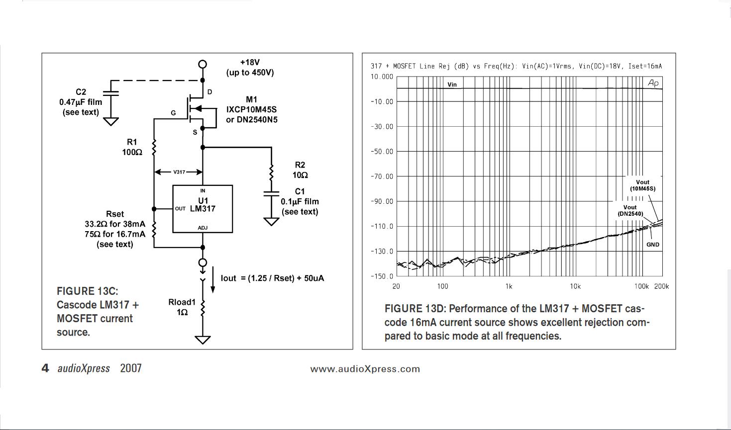

Thanks for replying! I have nothing against BJTs I just understand mosfets better. BTW, when I'm saying "my CCS" in post #1 I mean the one I posted, it's not my design. I.m not very good for that so I'm looking for something ready and tested. I will take in mind your suggestion but there is also another design that seems attractive. It can be found here https://audioxpress.com/assets/upload/files/Sources_101_P2.pdf-also attached. It works a charm for 40mA -tested but it's not suggested for lower than 10mA -not tested. I gather it's because of the LM317. Couldn't substitute this for a BJT?

I've been searching on this. Any suggestions for a two terminal CCS capable for high voltage (>100V) and low current (<10mA)?
The logical choice would be a depletion MOS-based CCS, very much like the jFET type, except NMOS are available for high-power and voltage.
Something like the DN2540 or similar, from Supertex and others.
Otherwise, the examples I gave, both the in the first and second thread, are suitable with transistors like MJE340/50, MPSA42/92, 2N5401/5501.
Edit: don't throw a 317 into a DN2540 CCS: it will bring deterministic adjustability, but other than that it is crap.
Use a cascode for high performance, but stay with pure NMOS, and adjust the current with a variable resistor, or better a selected fixed resistor.
I am sure there are suitable examples in the tubes forum
