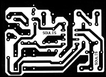

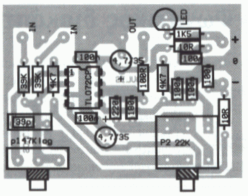

now this look interesting 🙂 Is it just simply connct parallel with my gainclone to the signal output source? By the way i will use one dualchannel opamp indeed of two mono channel op. But i still, don't get the meaning of R3, R5, and R7? why it need to be attenuater? For R3, is it tone control? and thanks, you have help me a lot 🙂

chchyong89 said:But i still, don't get the meaning of R3, R5, and R7?
R3 controls the overall gain, R5/R7 (dual pot) control the cut-off frequency.
