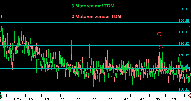

Here a result I got with Spectrum Lab with a 1 kHz test tone from a Cardas test record. TT was a Transrotor Fat Bob with a SME series-V arm. Cart was a Benz ACE. The TR is one of the most sturdy TT’s with regard to speed stability. What you see is the difference of the FB equipped with (green) and without (orange) their advertised TDM bearing.
Clearly visible is the 50 Hz torque ripple from the synchronous AC motor. Also you can see the 0.55 Hz spike from the not perfect centricity of the test record.
The cause of the other spikes below 50 Hz I don’t know…..

To give the levels an absolute meaning you can make a reference signal: Say a 3 kHz test tone FM-modulated with 0.1% deviation. This will give you then a reference level. You can make this with the build-in signal generator of Spectrum Lab itself.

Here a result I got with Spectrum Lab with a 1 kHz test tone from a Cardas test record. TT was a Transrotor Fat Bob with a SME series-V arm. Cart was a Benz ACE. The TR is one of the most sturdy TT’s with regard to speed stability. What you see is the difference of the FB equipped with (green) and without (orange) their advertised TDM bearing. Clearly visible is the 50 Hz torque ripple from the synchronous AC motor. Also you can see the 0.55 Hz spike from the not perfect centricity of the test record.
Very nice work. Can you please explain how you obtained this graph with the mentioned software?
Thanks, MArco
Hi Marco,
Oh boy, that is not said in a few words. I did it more than a year ago. If I have time I will post a screen shot of the set-up window next weekend. Basically it is 1 KHz signal in from test record --> FM-demodulator --> FFT spectrum.
FYI: In the above picture, a reference signal with 0.1 % deviation is at –90 dB. For regular W&F figures you have to integrate the spectrum and apply the appropriate weighting according to the standards. But the plain spectrum says more about what is really happening.

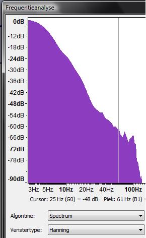

inspired by your postings of yesterday I gave Spectrum Lab a try and at once gave up on it. But it inspired me to have a (disciplined) go at it with Cooledit/Audition ...
It's what I got from a badly-setup standard Gyro MkV with VC supply.
Don't remember the test record used, as it is from an old file.
The 55Hz peak appears in most/all of my speed measurement attempts (over all TTs, and all drive systems), so is probably on that record. I need some time to sort this out and then pick the best LP for these things.
The wide bump at 10Hz is the cartridge/arm resonance. It would be wise to use a Shure M97 or V15 with damper, just for speed measurements...
But oh well, here's the procedure in short:
1) make recording of 1kHz lateral test track at 44.1kHz
2) read into A(udition) as 32 bit
3) convert from L(eft)R(ight) to M(id)S(ide) format (so L track contains M, R track contains S)
4) delete S
5) remove ticks and pops from M
6) filter M *twice* with a Chebichev2 band filter at 700 and 1300Hz, 11th order
7) adjust gain of M track to that its average RMS is -16dB exactly
8) find the average frequency of M using a 65536pt FFT
9) generate a sine of exactly that frequency in the S track (or R)
10) adjust the gain of the S track to exactly -16dB average RMS
That was the preparation ;-)
11) select S (R) and copy onto clipboard
12) select M (L) and mix_paste clipboard onto it with the Modulate option
13) downsample the whole file to 1.2kHz, 32 bit, mono (retaining only the L channel), maximal filter quality
14) do a 4096pt FFT over the central 20 seconds of the result, that's the W&F spectrum
