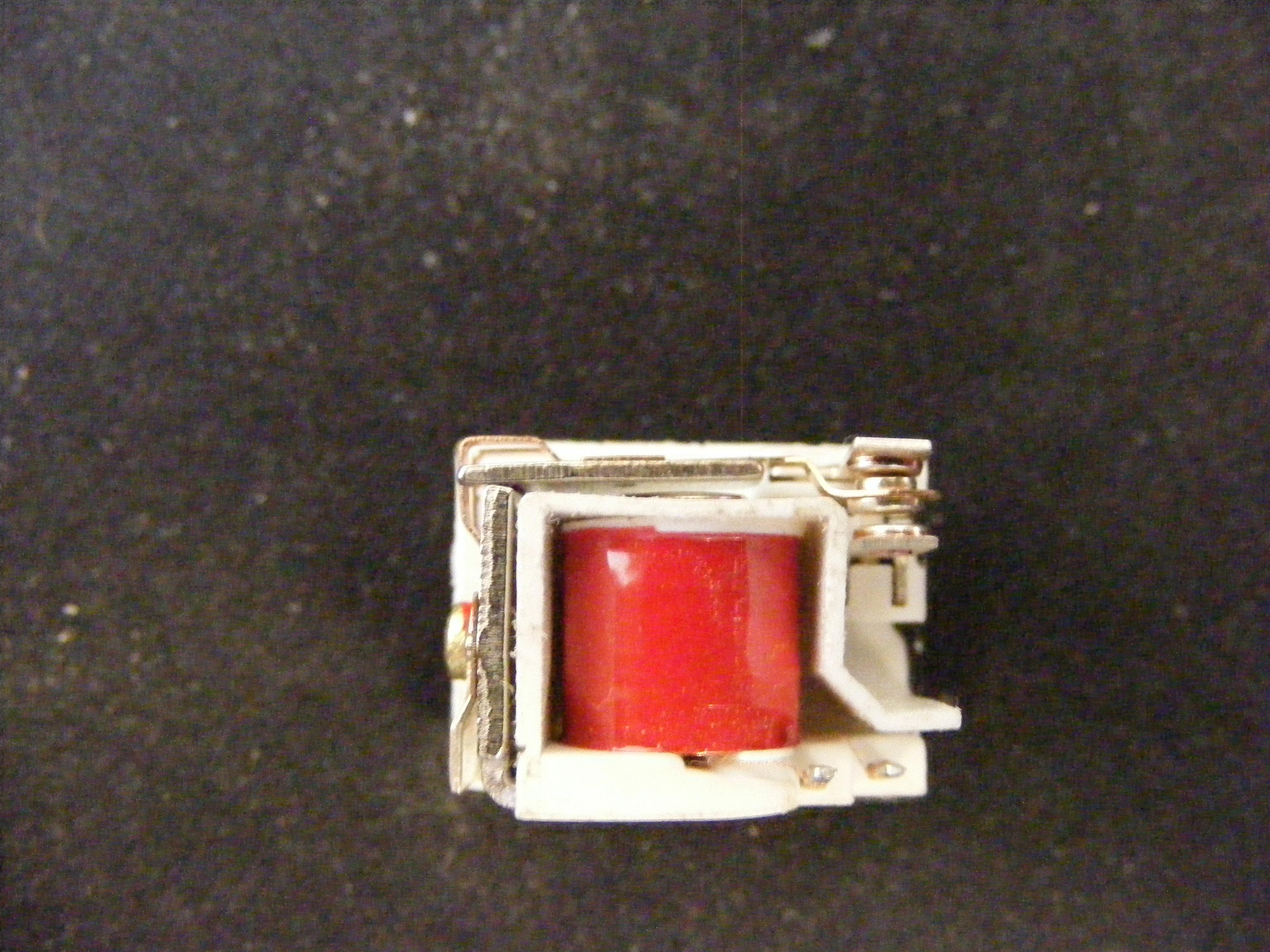

Attached is a picture of a gold plated contact relay that is not very good for audio.
The contacts are a button which is usually used for higher current contacts, there is a copper wiper but it is attached to the steel armature.
The wiper is influenced by the magnetic field of the coil when closed.
So it is neither a low level or low distortion relay.

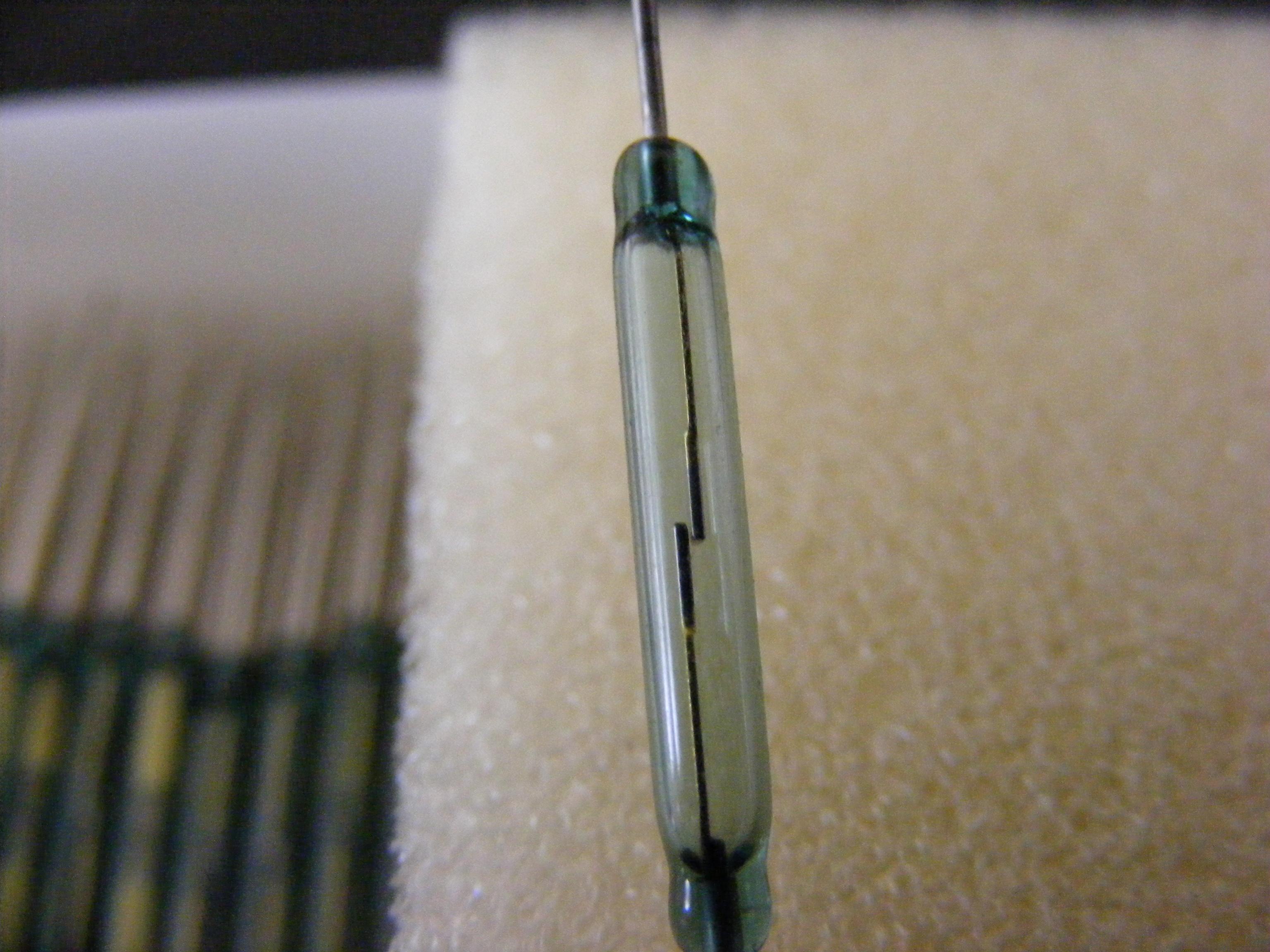

Next image is a reed switch of the type I am playing with. It does show changes in contact resistance when closed after a wetting currrent.
The data sheet is here HYR-2003-2 | Aleph-USA
So I'll presume Coto uses better switches.

As to the relay shown it is not a power relay, the gold plating on the contacts indicates it is supposed to be for low level switching. In power use the gold plating would vaporize. It will work for many low level signals but is not as good as the quad bifurcated versions. (Unless you meant the reeds and then those are what I have on hand and measured. But I don't think of a 1A contact as high power.)
