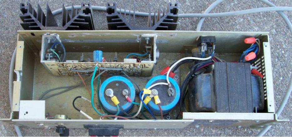

I'm wondering if anyone actually built a whole Amplifier just out of recycled components?
The case and soup can caps came from the power supply for the disk drive of an old VAX. The trafo came from a copy machine and was rewound. Rectifier and heat sinks from a battery charger. The outputs are 2N3773 and were "pulls" purchased at Skycraft. The drivers are all mis-matched and came from various sources. Small signal transistors are all MPSA06 or MPSA56 which came from a pcb loaded with TTL chips and relays. Speaker terminals came from a burnt up receiver. All the caps and resistors came from the 'stash', which may or may not have been purchased new at one time.
It's a basic blameless, and puts out 60W/ch at 8R and a bit under 100 at 4. I've been using it to run DJ monitors.
