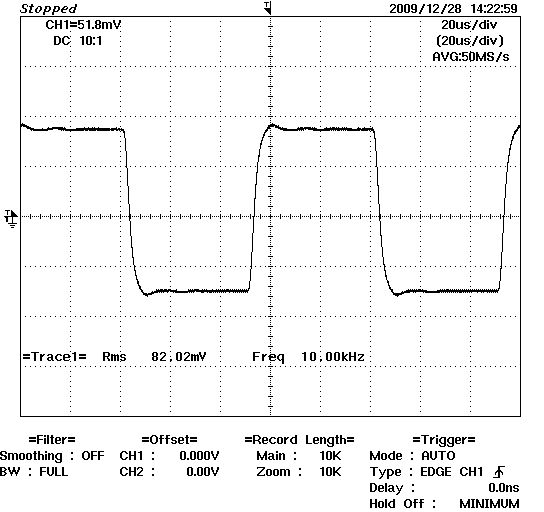

I received a reply with an explanation of a test set-up for an OTP I am speculating on for my up coming KT88 PP as I asked for a 10 kHz square wave test results.
They used 2 x 2,5 kOhm, one resistor on each primary tap to which a generator was connected with 2 V peak-peak, and an 8 Ohm resistor on the secondary 8 Ohm output, further on the B+ was connected to the secondary ground, is this correct way to set up an OPT for a square wave behaviour test?
btw this transformer has a 5 kOhm input impedance.

I would like to add also another reason for my question in the first post is because the square wave output looked too good and I have a feeling the 5 k resistors on the primary smooths out and shapes the square wave and dampens out the ringing, is that correct?

I see no problems with the 5k resistors but don't like the ridiculously low voltage/power levels.

Things like core saturation or certain nonlinearities will simply not show up using low voltages or currents; to get the most accurate result, you should try to reproduce the voltage and power levels which the transformer will 'see' in your application.
I am certainly no expert on transformers but would expect core non-linearities to be more obvious at meaningful power levels. For a large PP amp this should be in the region of 1W into 8ohms rather than a few mW.
ok I see, I think I would not be afraid of saturation or how non-linear at first though they are important too, what I want to know foremost right now is if the resonances are affected with the series resistor on the input because the square wave in the picture I provided has almost no ringing.

You want to drive the transformer from the same impedance as it will see in "real" use, and terminate it with the same impedance as it will have in "real" use. That's critical for measurement of bandwidth, resonance, and distortion. Unfortunately, it's not a trivial test to do unless you're willing to rig up a generator capable of delivering a few watts at a 100kHz+ bandwidth.
