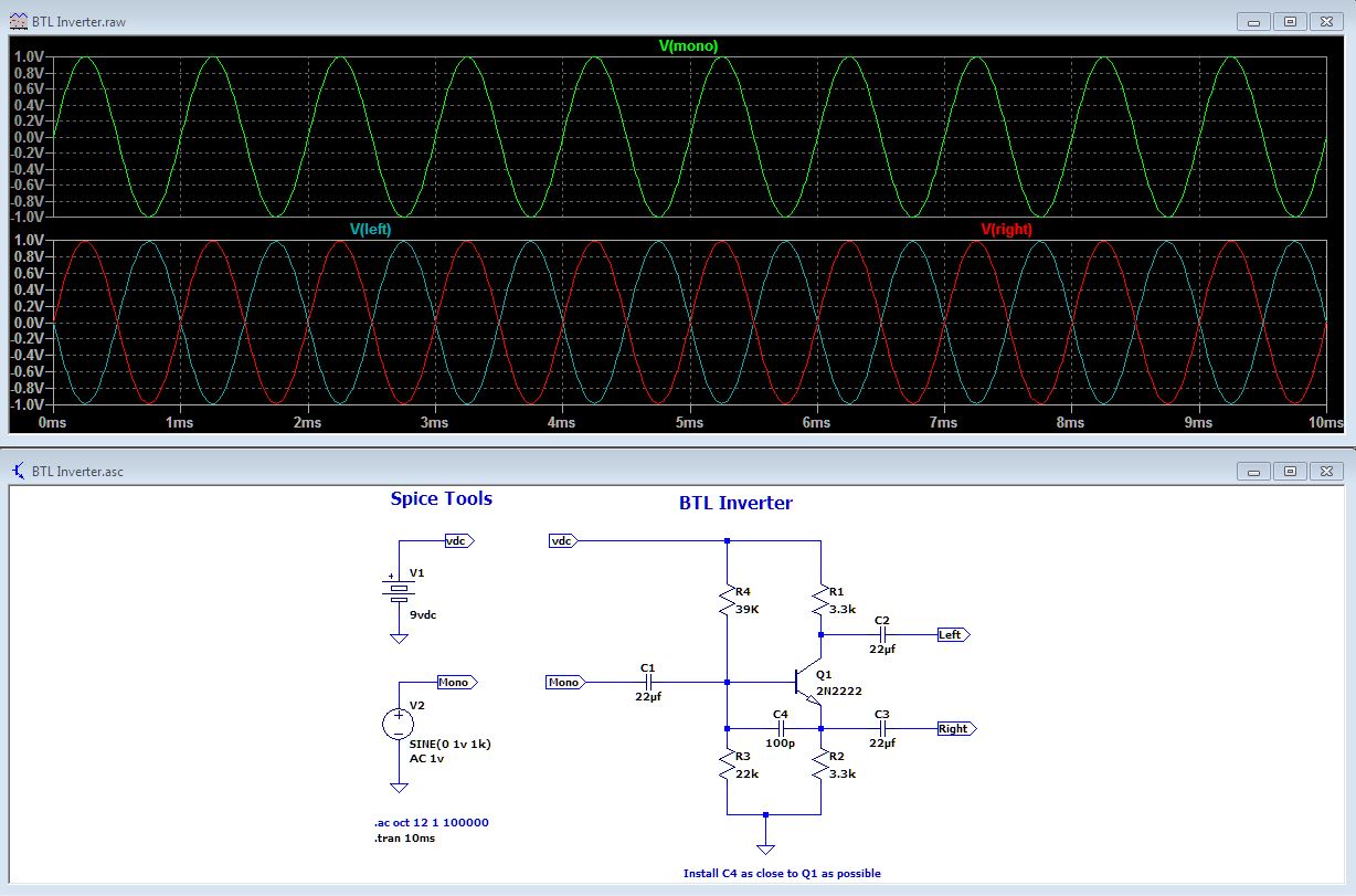

Sure can ... super simple Bridge Tied Load circuit below.
  • BTL Inverter.asc

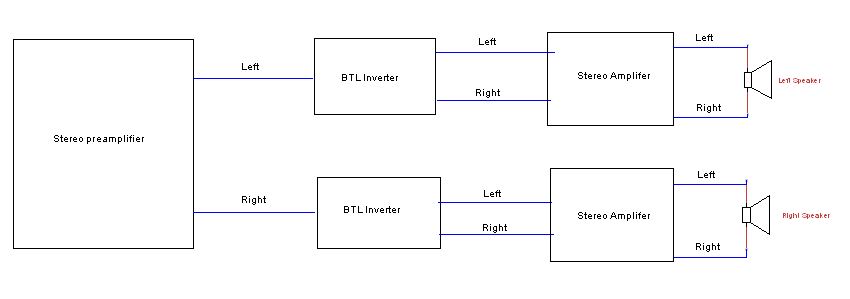

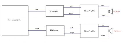

I can't believe I need to draw a picture ...
See the thumbnail...
No, you need one for each amplifier... then you feed the stereo channels, one into each of the BTL inverters each inverter feeds on stereo amplifier then each stereo amplifier then feeds on speaker.

You might have identified a gap in the market...
It's not usually a recommended procedure because of current limitations but any stereo amp that can tolerate 4 ohm speakers can be bridged with an 8 ohm speaker without much danger. It's a simple one transistor (for each channel) circuit, as I posted... stick it in an altoids tin and away you go... change your mind? Just unplug it and hook things back up normally, no harm no foul.

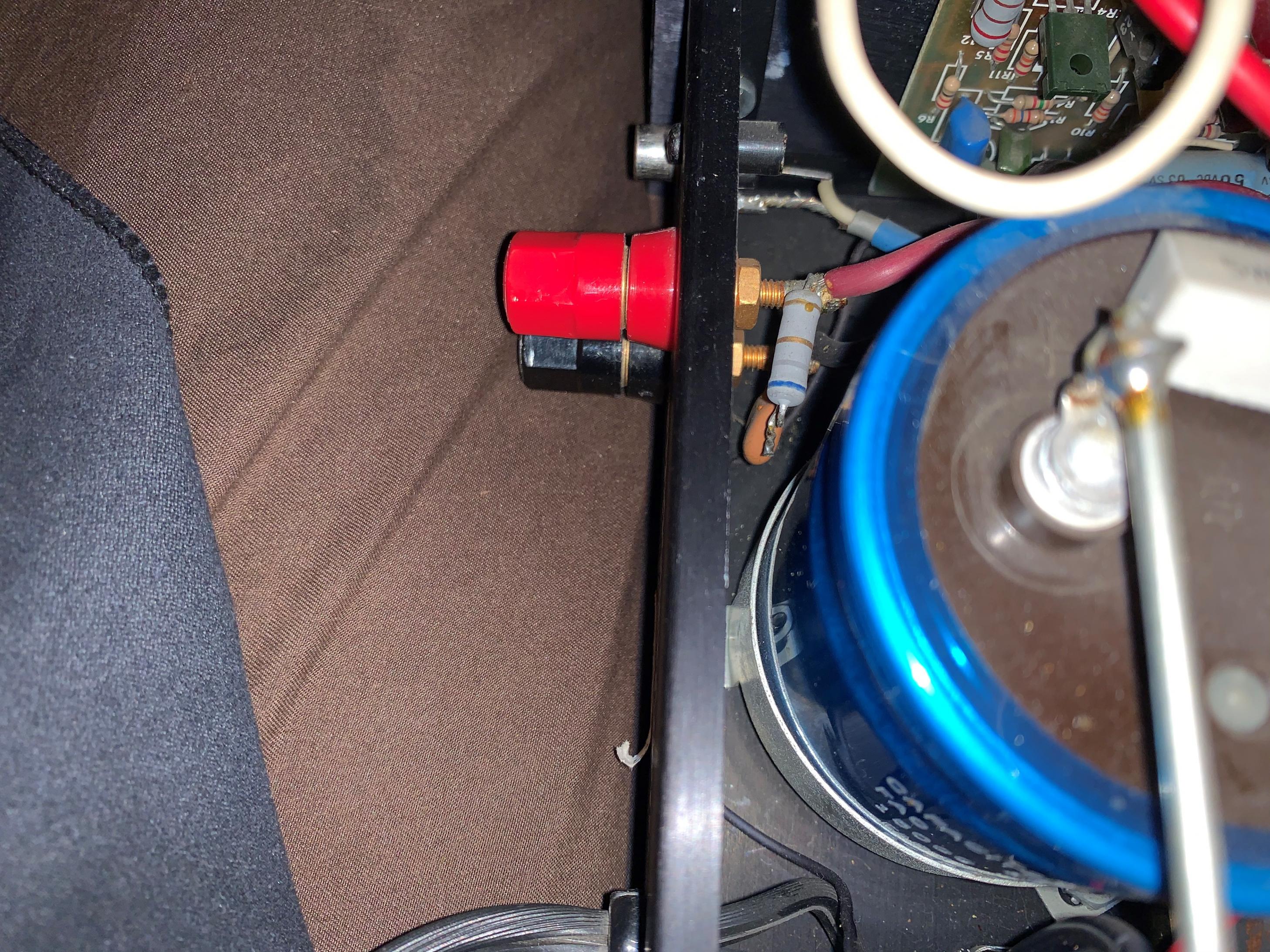

I am not sure I follow what you are saying. I thought it was interesting that you mention a resistor on the output because on one of the two amps there is a resistor and I think a capacitor. On the other amp the resistor is absent at the output posts. I've wondered why one amp has it and the other does not. Any ideas why that is?
