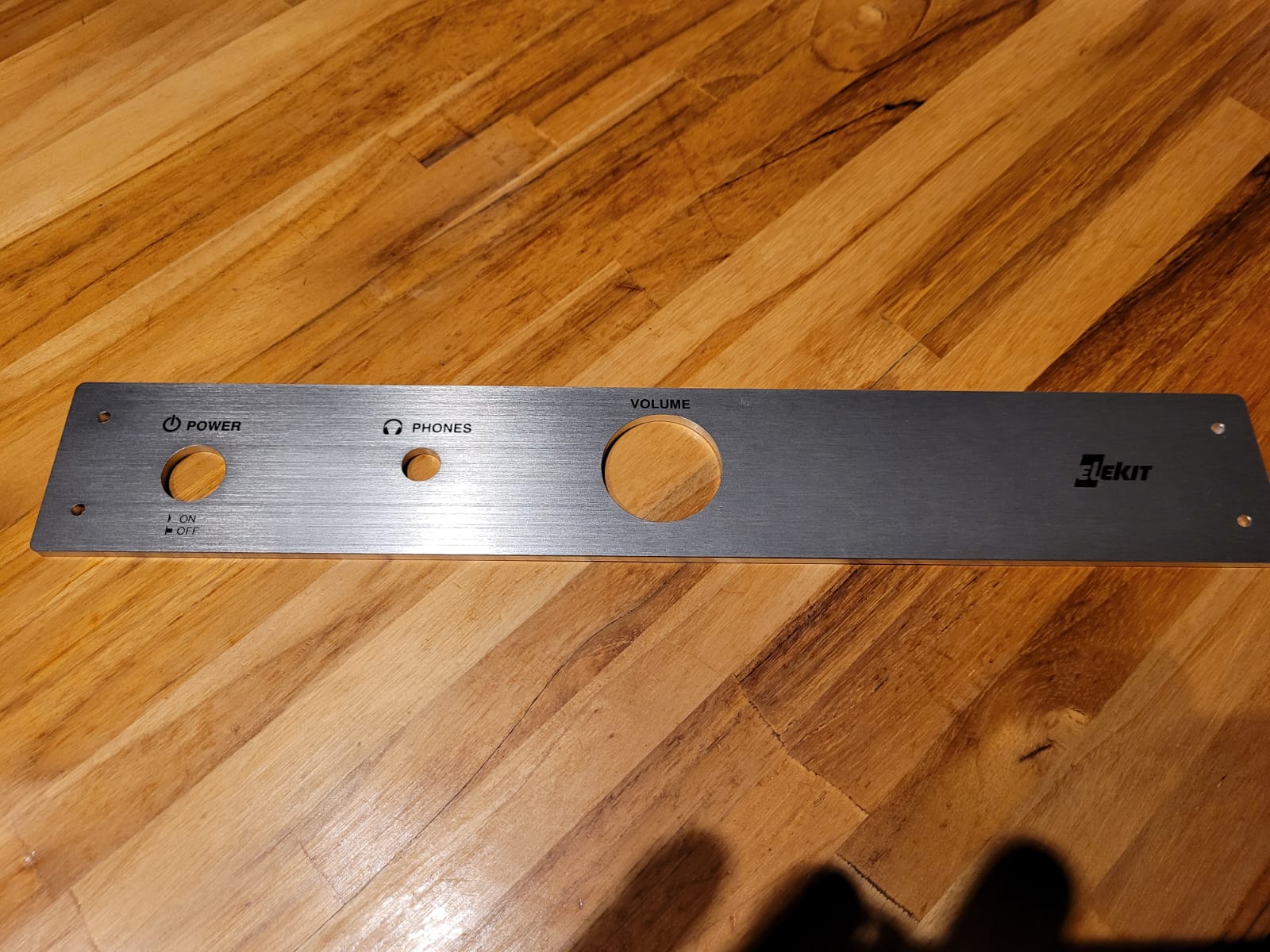

Hello all!
I would like to remove the texts (Volume, Phones, On/Off etc.) painted on the front of my Elekit 8900.
Have anyone done that and could inform the products to use to do so?

I haven't done it, but the first thing I'd try is acetone as it shouldn't damage the aluminium like some paint strippers.
Another option may be one of the citrus based paint strippers or cleaners used for removing adhesives. I'm just thinking of options to avoid leaving marks.
Cellulose thinners? Or any commercial paint brush cleaner applied with cotton woola cloth, or paper towel. I'd steer clear of anything strongly acid or alkaline (most paint stripping chemicals) and wash yourself and the faceplate as soon as you're done. Don't soak it in a bath of anything...

The back not being symmetrical, impossible to use it, it would have been perfect. Both side have the same aspects. I just delivered the other parts (all the ones paint in black) to a place where they will paint them with electrostatic paint (a dark red, couldn't find the exact color, but getting close). All they said is: "don't blast it (if it makes sense in english, this is when you remove paint using sand, for example), you will loose all the brushed metal effect". "And maybe try acetone". Didn't get the courage to do it so far...

Garage door paint seems to be the thing to use (no separate primer needed). Certainly works a treat on diecast aluminium enclosures. Probably good for anodized as well. I thought only alkali attacks aluminium.
Soak text paint in acetone, at least overnight (meaning 8 hours or more) because it´s most certainly 2 component Epoxy.
It won´t actually dissolve but become weak brittle and can be removed with steel wool.
Make some kind of jig or guide , even out of wood , to re-brush panel same way as before.
In a way it´s a blessing, because you can re-do it and get the same effect.
Not sure I understood you well: will you later paint the whole surface with a solid colour?
In that case you will need a wash primer coat first, or use some aluminum specific paint which is self etching.
