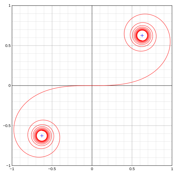

The Horn of Freehafer [3], made popular by Geddes, is based on the Oblate Spheroidal Coordinate System [4]. Geometrically the horn is of infinite extent. When truncated, a detraction edge is presented to the outbound acoustic waves. To mitigate the attendant reflection of waves back down to the driver diaphragm, curved lips are added to form the horn mouth. The optimal shape of these is best approximated by a segment of Euler’s Spiral [5] (my conjecture).

[5] Euler’s Spiral
Euler spiral - Wikipedia, the free encyclopedia

By the way: what's your mathematical method to determine the segments of the roundover for the horizontal vs. the vertical sections of the mouth? There are simplified formulas to determine an Euler spiral (segment) for a given length and curvature without using the complex Fresnel integrals. I'll post these when/if I can dig them up.
