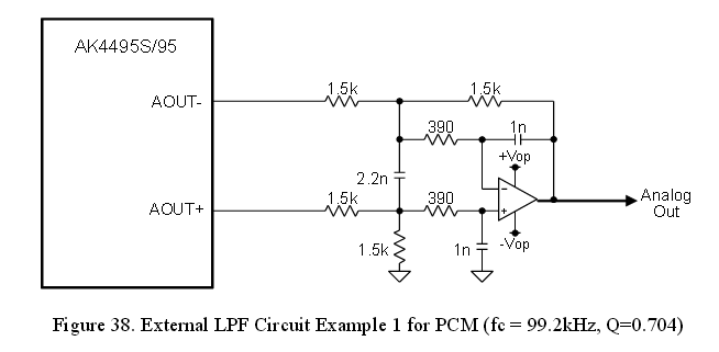

How to reduce dac output gain?
The opamp's gain does not determine the signal gain in your circuit, rather resistors do. If your DAC has this application schematic from the datasheet, then you'd need to increase the '1.5k' resistors connected to the DAC's output pins. You'll also need to decrease the capacitors proportionately.
What type is the best? Should they be low tolerance and matched?
These should be 1% metal film, 1/4 to 1/2 watt. Dale RN60 or RN65 are good.
You can match them between channels if you want, but any channel imbalance due to tolerances will be very slight.
The most it could be with 1% resistors is 0.34dB. Usually, with a typical spread of 1% resistors, it would be about half that.
Of course, you can make the two resistors unequal, to have a value of attenuation other than 6dB.
For example, if the series R is 4k and the shunt R is 2k, the atttenustion is 9.6dB.
The output resistors will not affect the op amp's operation. Just make sure the total load on the op amp
is higher in resistance than the minimum load specified for it.

Lower output impedance is better, but keep the total load on the op amp more than
the rated minimum load for the op amp. More than 2k should be ok.
For -12 dB, you have -12 = 20 x LOG (loss), which means the loss is 0.25.
Then the series resistor could be 3k and the shunt could be 1k. The output impedance would be 750 Ohms.
The 3k ( actually 3.01k) and 1k are standard values of 1% resistors.
