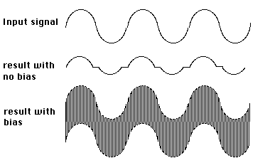

I can't remember the signal amplitude to the record head of this kind of deck. I would guess 20 volts or so would make a recording, but what you have to remember is that it will use AC bias. That means that you should see the audio, amplitude modulated on a superisonic carrier. If the bias is missing, you will make low very distorted recordings.

Seems the oscillator isn't working properly, if at all.

Low level audio to the head should not cause distortion. That is what the bias is there for.
