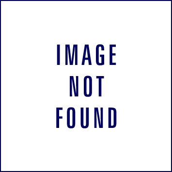

Here is the schematic for clarification.
I just added channel A. Channel B is of course the same.
