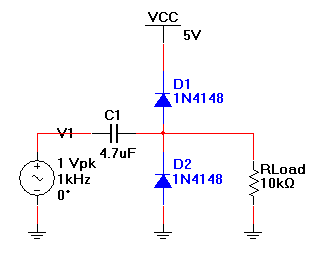

This looks a bit like the input to my Boonton THD% Analyzer (you have the luxury of a bipolar supply in the analyzer, however). If the sound card looks like a 10K load the 4.7uF cap should give you flat response down to a few Hz.
If there is any DC offset on the amp it will show up on the other side of the capacitor -- the two diodes will limit any DC -- the input to your sound card is probably capacitatively coupled

this weekend i put together a sound card protection circuit.
thanks for help!
i left out the capacitor because i would like to use the device during phase measurements and because jackinnj said: 1. that DC will still get across the cap and 2. my sound card is probably capacitatively coupled anyhow.
however, i did not implement the circuit that jackinnj suggested because it was over my head. i did not understand how that circuit would protect against DC or the function of the 5Vcc ( i assume they are related).
i incorporated a shunt resistor and used a different value series resistor. i hope this change is inconsequential?
i tested my circuit, and the diodes clip at the expected voltages. my only concern is that the protection won't last very long as the diodes get hot (and ring) relatively quickly. i guess the solution would be to use diodes with higher current ratings.

I'm working on an active version (using Opamps) at the moment, and see some problems with your circuit....
Your scope would have an input impedance at app. 1 MOhm.
Depending on the switch settings of your box, the input impedance could be as low as just a little above 1K.
Measuring 40V with 1K input impedance means a current load of 40mA from the circuit you have under measurement. This is ok for Power Amplifier output stages, however if you try to connect your probe to a more sensitive circuit like the VAS stage you may end up with some blown low power transistors....
