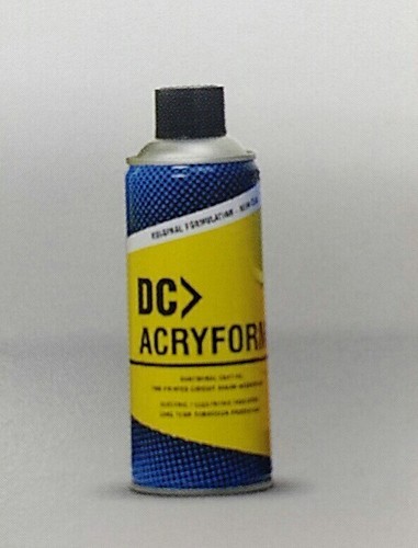

There´s a product specifically for that use, called "conformal coating".
Only "problem" might be minimum order could be "too much" for a single project, but, hey!!!.
, just ask 🙂
Hope everything is soldered, no sockets /pots/switches in the coated board.
Or you might pack it inside a later sealed plastic cabinet or even a humble plastic bag, easy to cut open if later needed.
EDIT:
Ultimate Guide to Conformal Coating | Chemtronics
Acryform...
