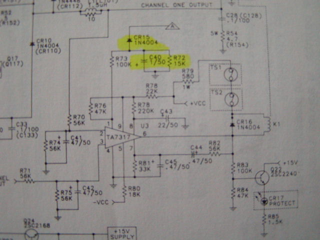

Pigy,
I bought a few weeks back on ebay, TA7317P chips from Toshiba.
I tried them on a breadboard, the circuit works fine.
It has both the delay on and direct off function as you require.
With component values of the circuit below it also shuts down below frequencies of 5Hz.
The nice thing with this chip is, that is work up to voltage of 60Vdc. Untill now I had for each amp I've made, different DC detection, delay on an direct off circuit.
I use this circuit to drive two AMPLIMO LRZ relay's, on for each channel.

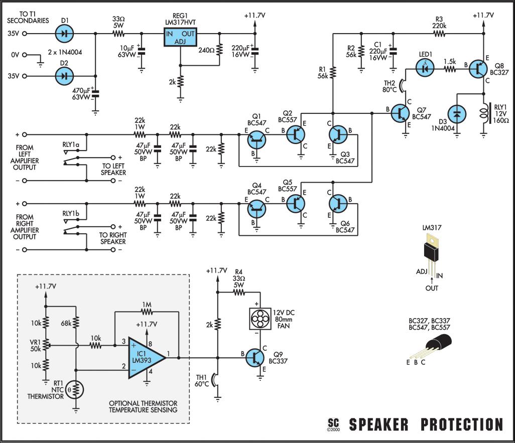

From SiliconChip magazine
Well, this is not an universal solution, but works very fine.
It has been designed based upon a circuit from Silicon Chip magazine, found also on the internet.
If you find any trouble ask me and I can help you getting it up and running.

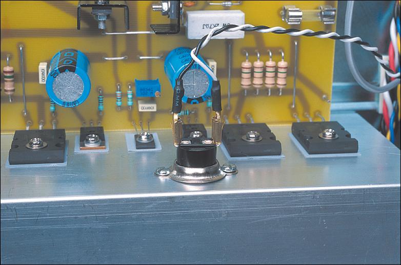

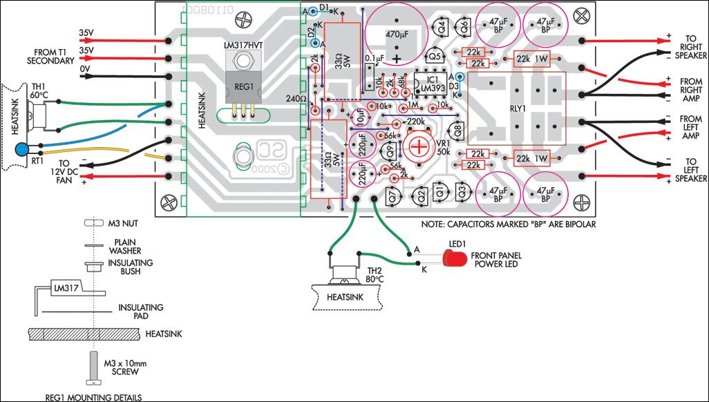

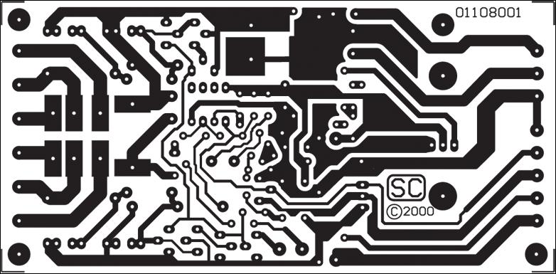

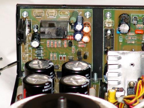

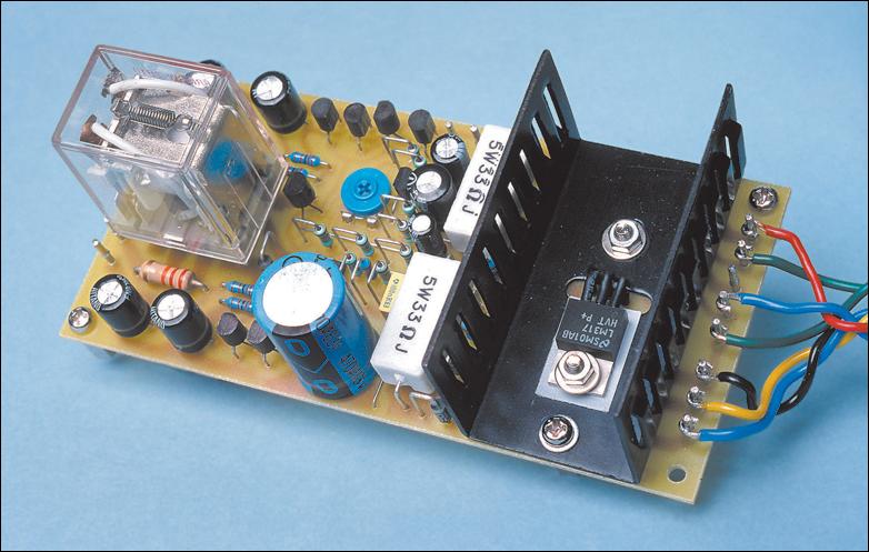

My home DIY amp uses a pair of boards (one for each channel) with 100% satisfaction.

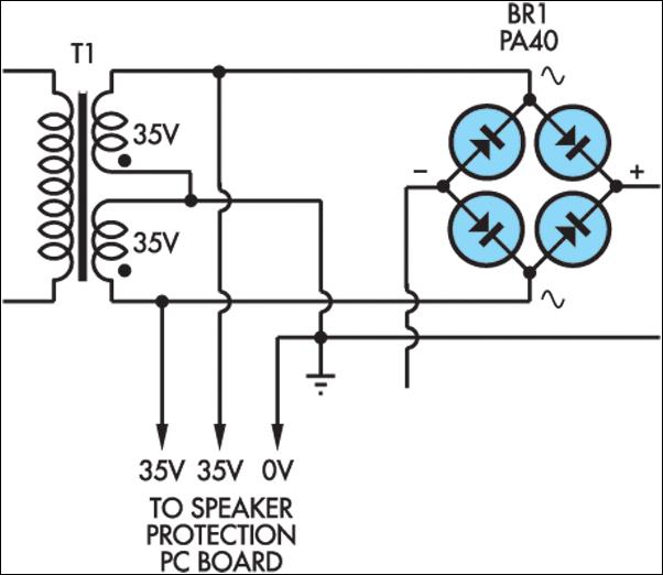

Further information and board layout may be found here: * "http : // dx . kinghost . net"(Loudspeaker Protection section: http://www.nabucoeletronica.com.br/dx/files/spkprot-schematic.pdf).
It would be nice if you could post your amps' schematics, so it would be easier for us to help attaching this unit.
