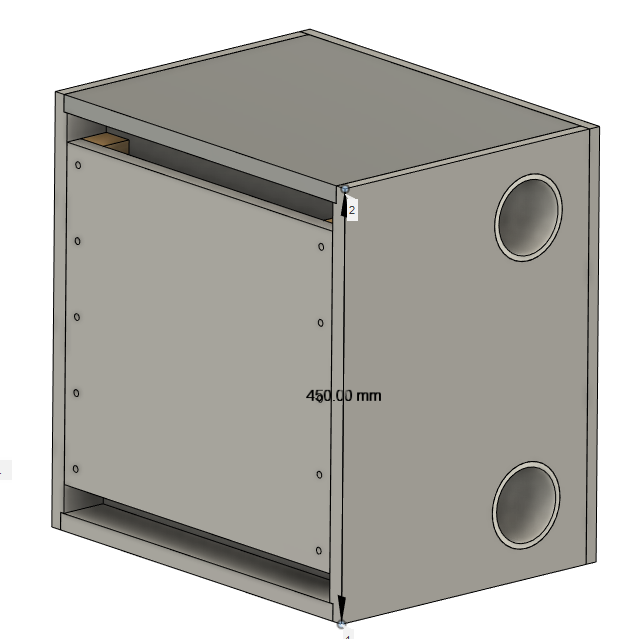

You can also mount the round protective grills on risers.
You make such risers easily using thick walled tube and a hacksaw. I've a couple of old Tandy/RadioShack grills and they are anything but flimsy
I hate grills so my solution to this is to recess the speaker in its own small front chamber and use a wooden driver cover with a gaps at the top and bottom. It does not effect the response until 100hz+ where it starts increasing effeciency.
Thanks - I think that this solution would give me a lot of other problems (the speaker is not a sub-woofer, but actually a 2-way).
But this design would surely solve the Xmax problem.
Martin
