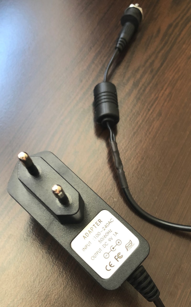

Here is a picture of one.
pasteboard is not a good place to host images. Re-size appropriately and host here. See below.
What happens when you try? Smoke? Buzz? Do you have a voltmeter? Does the voltage read right both no-load and full-load? Is the polarity correct? What happened where the shrink-wrap is near the RFI-lump?
When i try to power the ic with this adapter, i get highly distorted audio signal . Adapter gives about 9.35 volts as i measured, also polarity is correct.

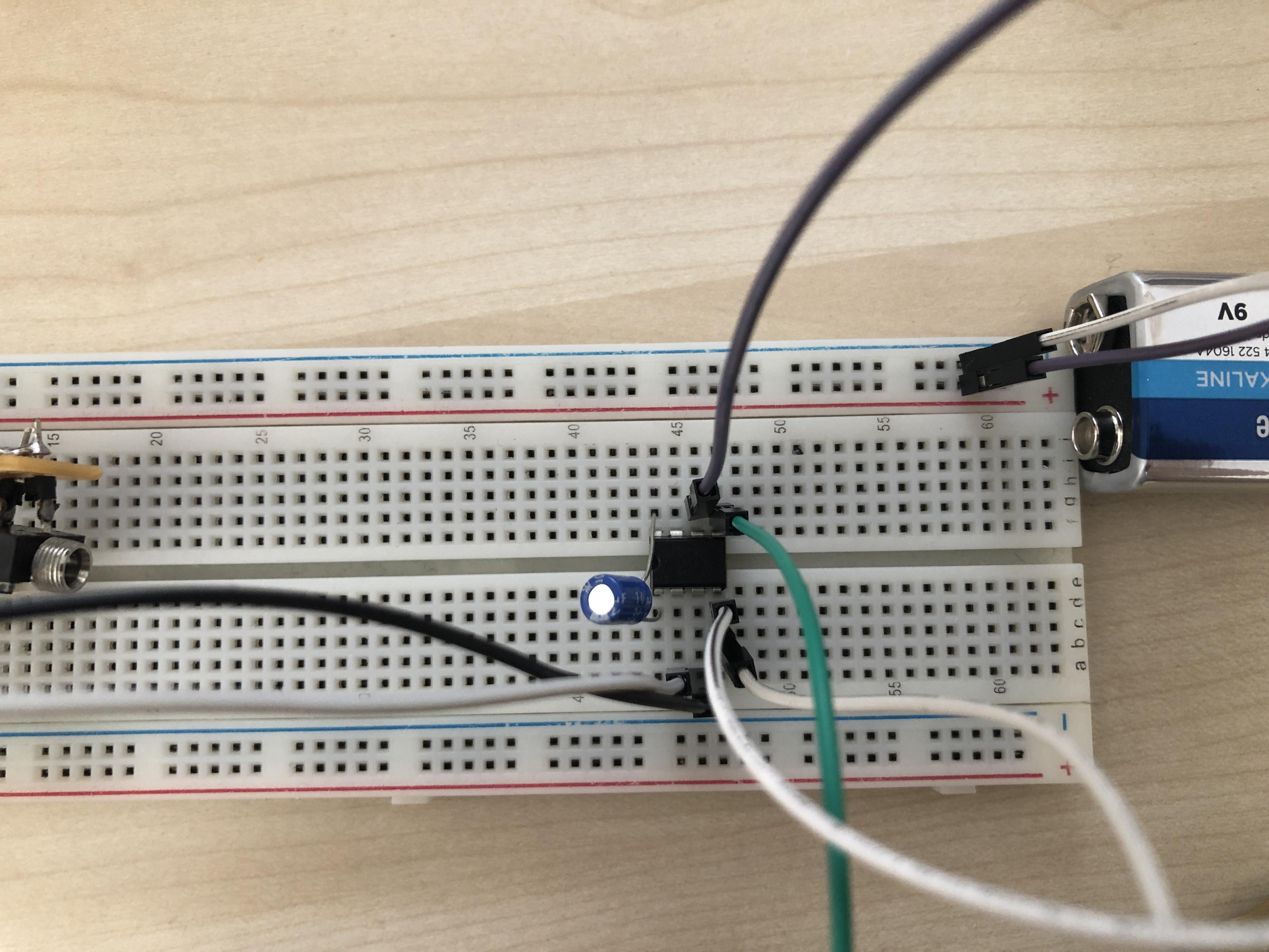

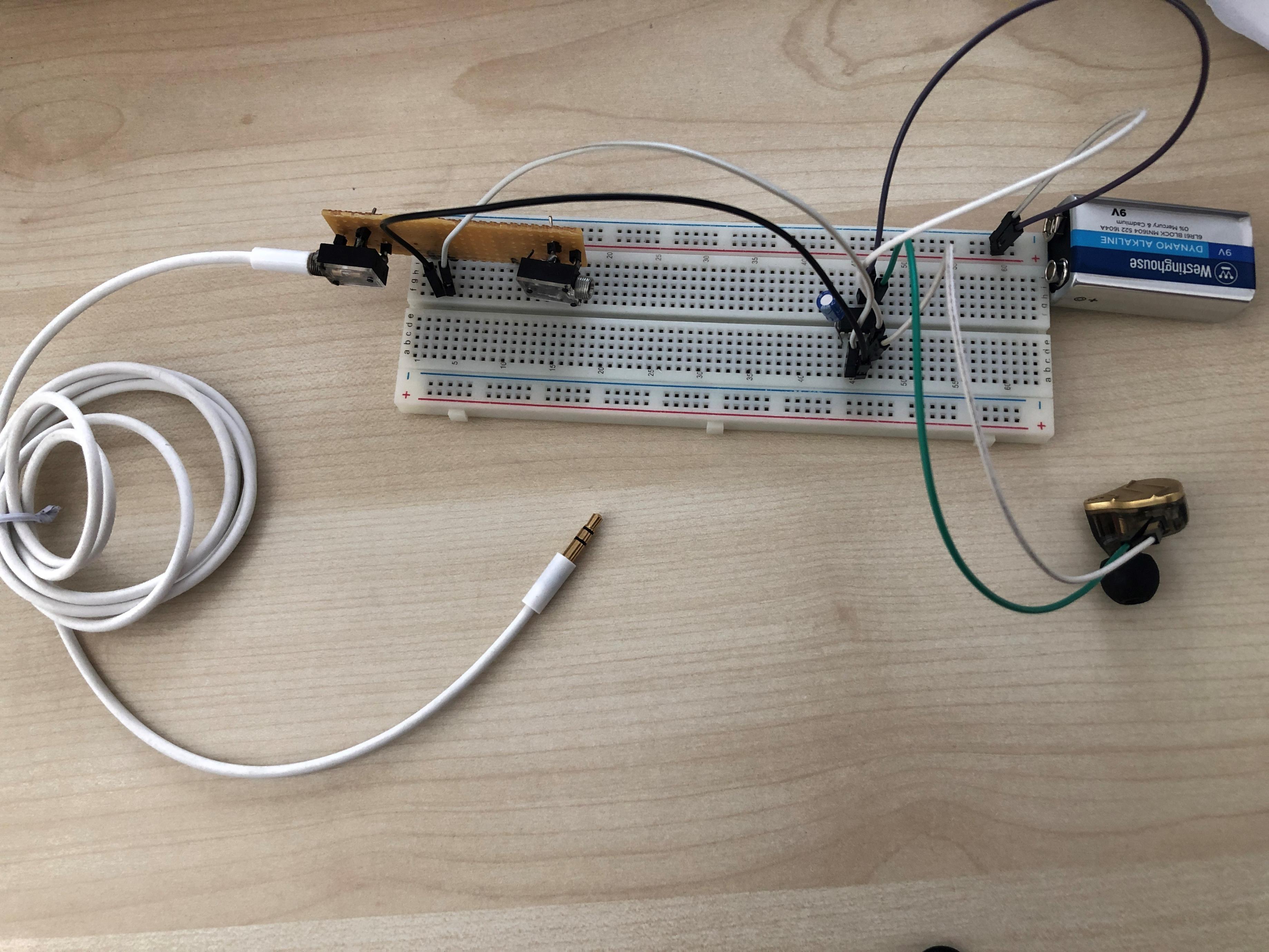

Post a picture of your actual build.
Maybe/probably there is some grounding/decoupling problem which is easier seen than described.
The old "one image is worth 1000 words" 😉
Batteries are less critical in that aspect, they don´t hum, buzz, ripple, hiss, etc. but switching supplies often let some switching noise/hash through, let´s see what you have.
Well connected, it MUST work, and 1A is more than enough.

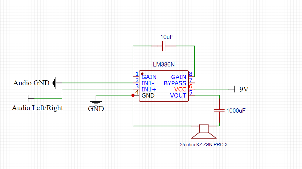

Here is my circuit

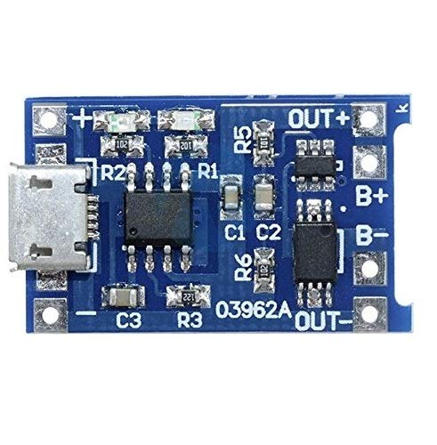

I'm also planning to use a 18650 li-ion battery hooked into a continously charged charging module if i will not be able to find a way to supply the circuit.
Thanks, I asked for an actual picture of your build to troubleshoot it.Here is my circuit
Schematics do NOT show actual grounding, wire paths, layout, etc.
Are there any mistakes in my circuit ?
You do need a bypass on pin 7! Yes, sometimes it works without, but not as designed, and is super-susceptible to power rail feedback.

bypassing
Thanks for your reply, how can i bypass lm386 ? When i try to add an electrolytic capacitor between 9V and GND, it warms up after a while.
After taking a look at adapter, i saw that there is a cylindrical part connected to adapter's cable in series. It may cause distortion in circuit but i don't know.

sorry for late reply
I assembled the components to perfboard, i solved half of the problem with using a 7805 voltage regulator. But after a detailed research, i think i found the main problem. Ground looping. I tested the circuit in different rooms, different ac sockets. And i noticed that when i tested in living room there is no more noise except lm386's own noise(there weren't any devices plugged into sockets ). I'm gonna use this circuit when i'm using computer. So i don't want to listen noise instead of music. What should i do ?
