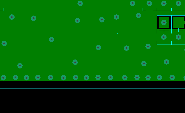

Hi all!
What i did in my last layout (2 layers). It is 100% analog audio design with linear opamps NE5532, LM833, DRV134 OMRON G5V RELAYS, linear dual psu.
1. All signal traces and power traces are on top even if this forced me to place wire jumpers, and all traces are 0.8mm wide.
2. My ground plane is free of traces...(except two very short.. in a feedback path).. i will try to re-route...
3. All the thru hole pads with copper in between each pad
4. Pad clearance (distance to ground plane) 0.3mm
5. I use sprint layout software for layout my boards... it has an "X ray mode" so you can check if top layer traces cross with anything on the bottom layer...
So i checked that below each trace on top layer, there is only copper on the bottom layer.
Regarding stitching, so i just have to "pepper" some vias.... and this not only for thin "antennas like" areas, but also for larger areas...
¿What is is the usual via size for stitching?
thanks a lot!!
usually whatever your standard via size is, no point adding more drill holes... We tend to use 0.3mm finished vias as standard on analogue boards, sometimes larger for simpler designs.
And a bonus picture of vias.... how exciting😀
