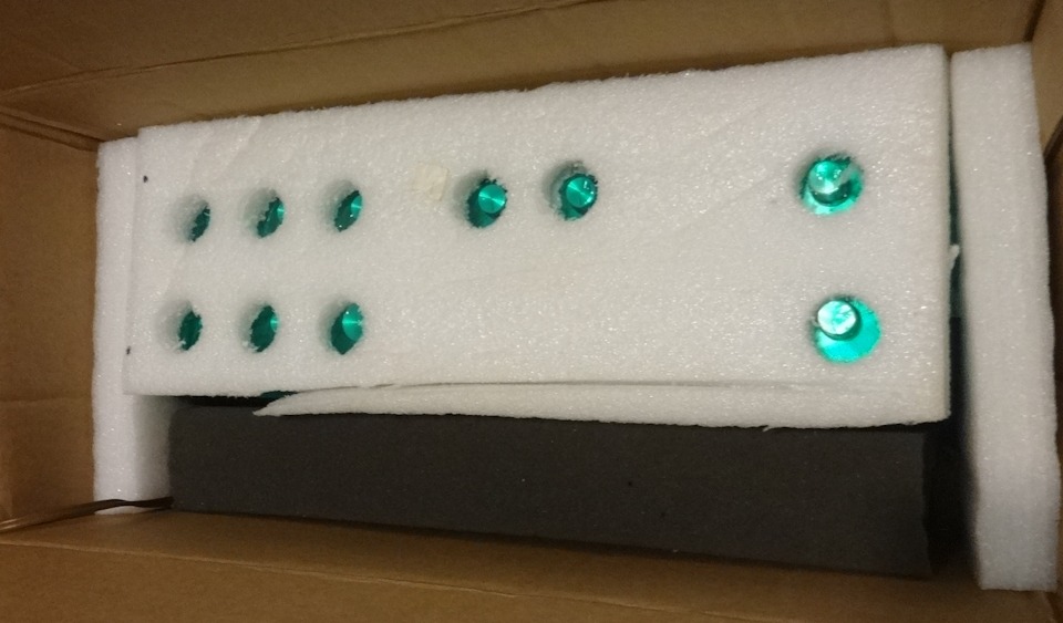

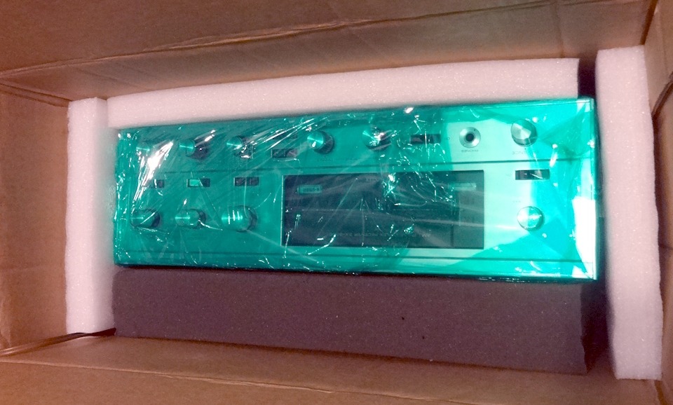

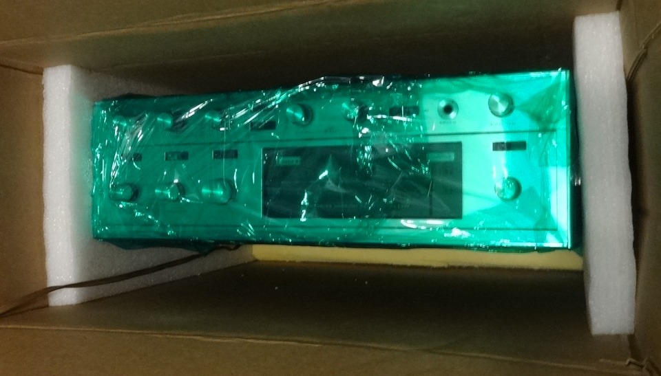

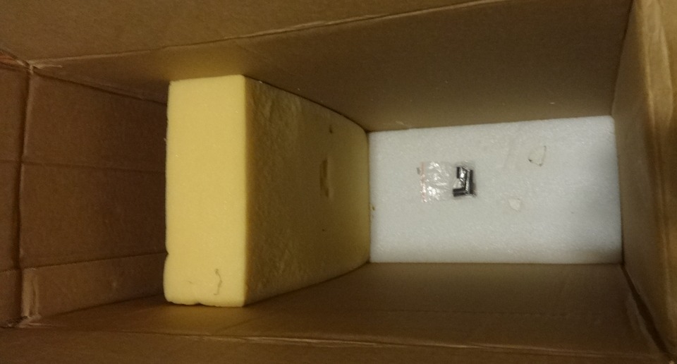

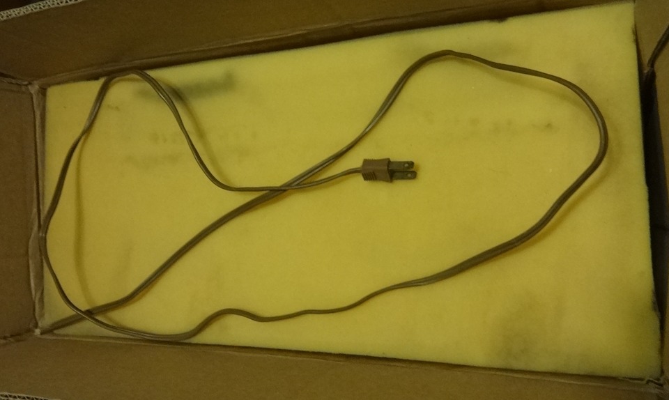

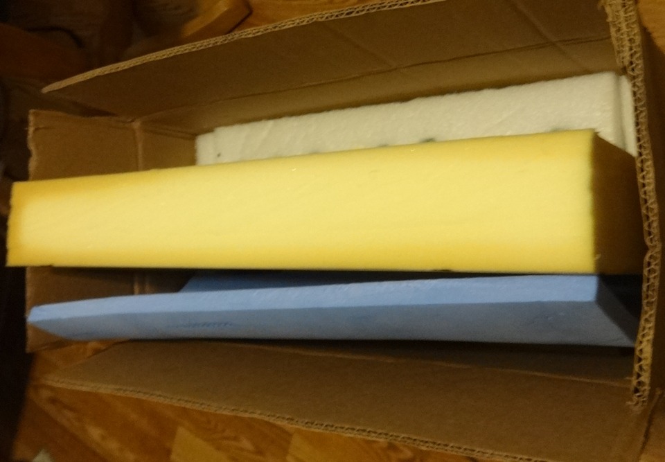

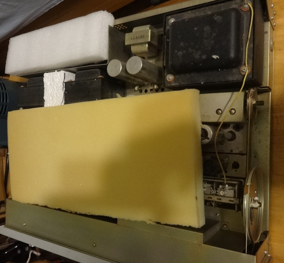

I sold the Pioneer. Here's how I packed it. I removed the feet, placed them between the thick softer foam and bottom hard foam.
Two layers of foam on each end, harder stuff on the outside. 1.25" poly foam on sides and footless bottom. 2.5" open cell pad on the top, which should provide softer deceleration should it be dropped on that side. Some under the hood protection for the tubes, to encourage them from not popping out. Knob protector layer, with additional 3.5" foam to the container end.
Hopefully they wont break it during its travel. 46 lbs container weight. Took me all day to create the package...used up most of my best materials...I was lucky to be able to get 'er done.
