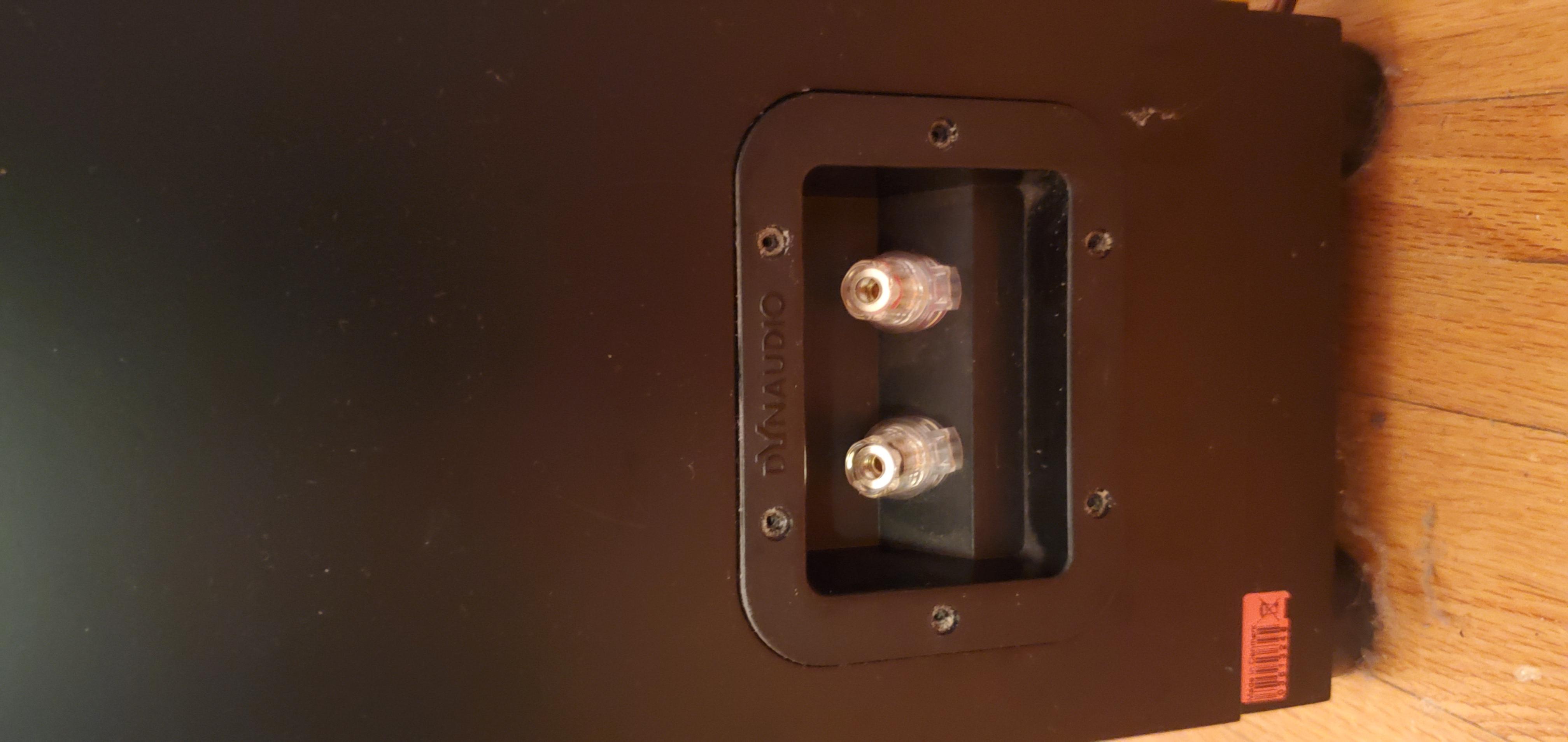

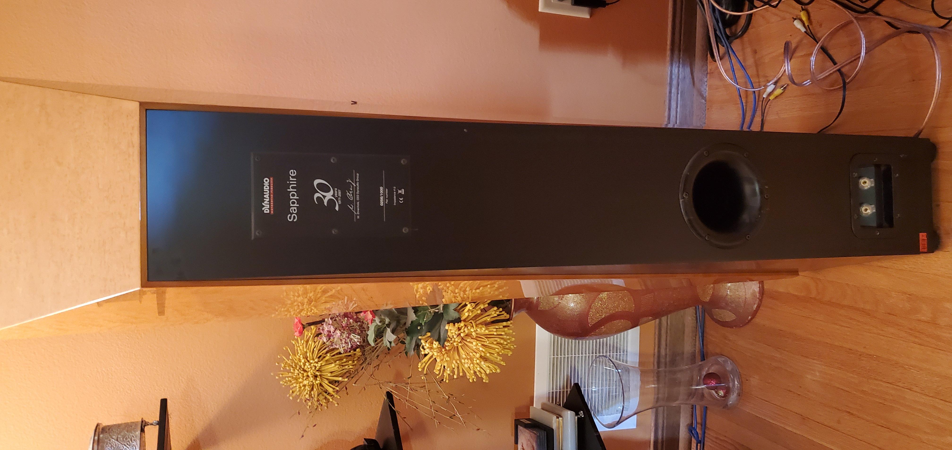

I have Dynaudio Sapphire's and both the woofers on one speaker have stopped working.. I have tried basic troubleshooting with switching cables between left and right and the same speaker does not work.
I am trying to open it to test the crossover circuit and was hoping that the area on the back where the cables are connected can be opened. I have opened the screws but the "thing" does not budge.. (see attached pic)... I don't to damage it.. was hoping I can get some guidance on minimal opening to test out the crossover..

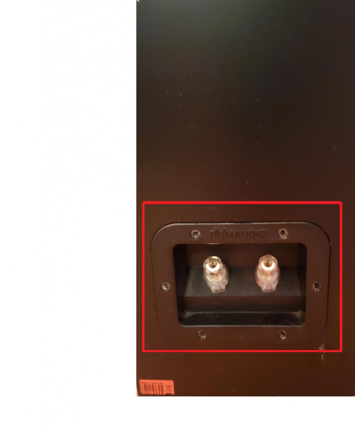

Is there a way to open the back part (highlighted with red border in picture below) to expose the crossover for advanced testing.. Do I need to use a sharp object to pull the highlighted item or is there some other way to access the crossover board?

One would like to think on that expensive of a speaker, the xo will no be attached to the binding post that you are trying to remove. It also looks like it might be tight trying to access through that hole and like tick pop, I would pull the lower woofer.
If you continue on the back you can try wiggling the posts while pulling on them and see if you can work it free. There's likely a gasket that has bonded to the cabinet. If that doesn't work you will need a glazing prybar and work around the edge until it begins to loosen.
Hi Idaho,
try to get the woofers out to get access into the box. But be warned: At some periods during their long history Dynaudio has used a special glue, silicone-like, as a gasket. This may have been used at the terminal, too, and it may have been used at the drivers. If so, it will be difficult to unmount them, but access to the crossover is likely to be a lot better through the woofer cutouts, I don´t think that opening the terminal will be sufficient.
Good luck
Mattes
Thank you folks...As suggested I opened up the lower woofer and could access the crossover as well.
As it happens..both woofers have infinite resistance and so I am assuming that the voice coil is gone. Thank so so much.
