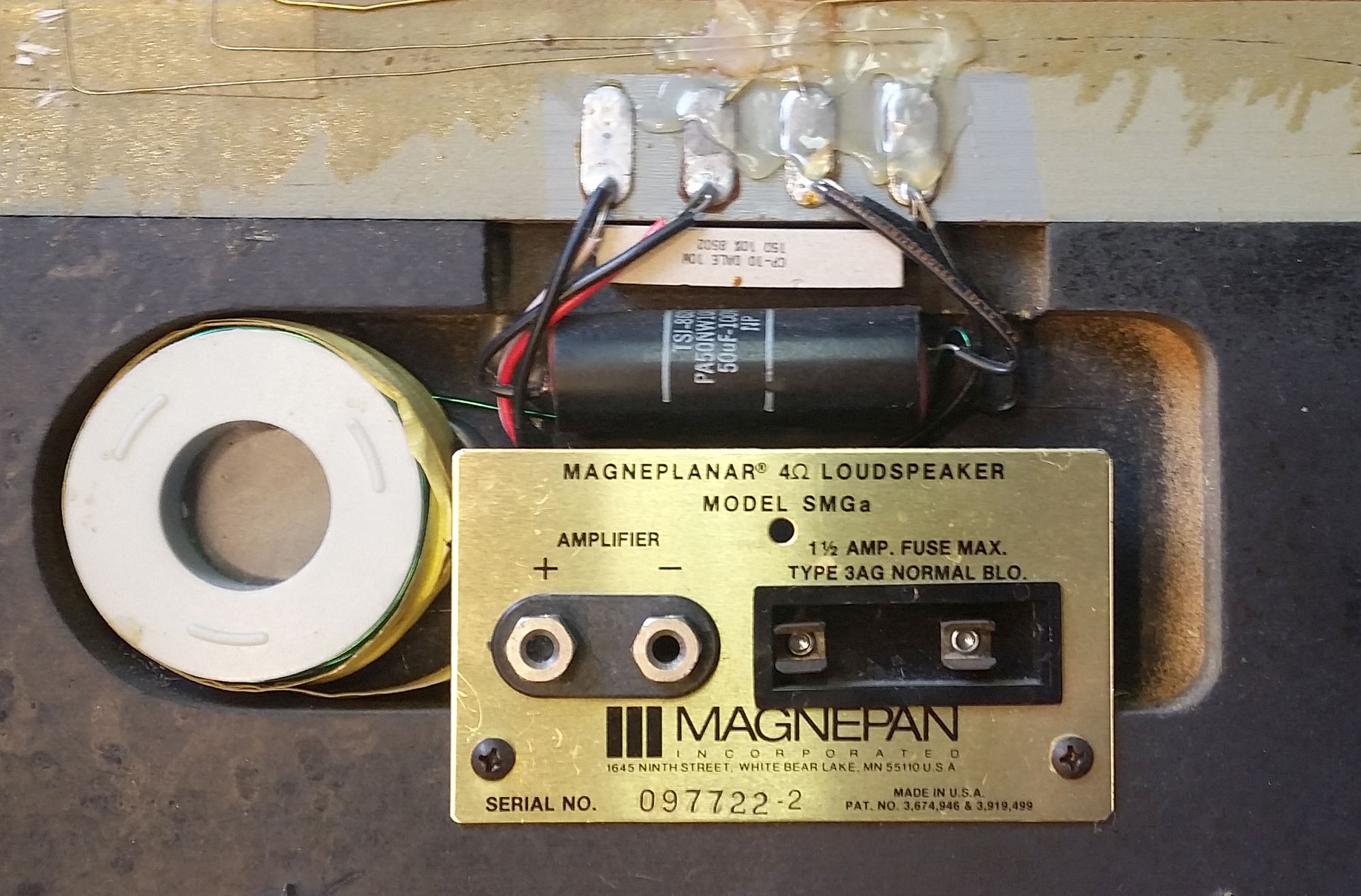

I've got a set of Magnepan SMGa speakers that I'd like to biamp, but I'm pretty well clueless as to how to do it.
How to wire it for biamplificaton:
First, disconnect the existing crossover.
Then do I keep the inductor in parallel with the mid/woofer?
And keep the capacitor in parallel with the tweeter?

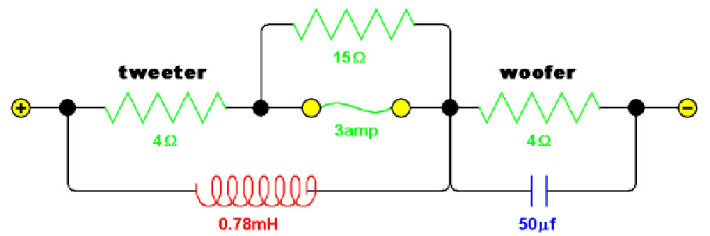

With passive bi-amping you need to separate the XO into 2 discrete XOs and drive each with its own amplifier. The passive XO is a series XO so a new XO configuration would be needed
With an active XO (real bi-amping) you eliminate the XO completely. The starting poing for setting your active XO is to get as close to the passive XO as possible (passive is 1st order).

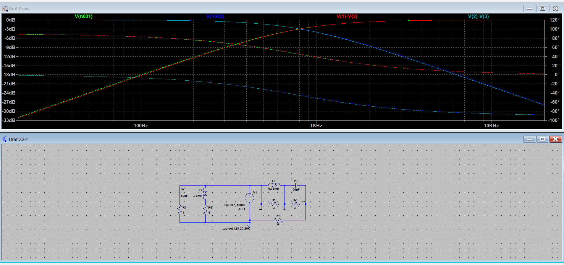

As others have alluded you need to remove all of the existing XO parts. The tweeter is somewhat fragile so the fuse should be retained.

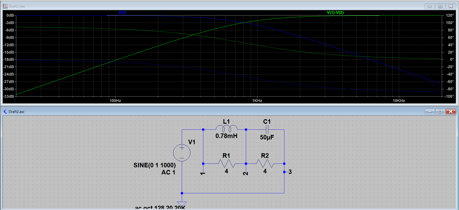

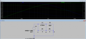

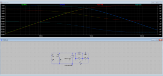

I have include a simulation of the current XO response. Because the drivers look predominantly resistive the response is pretty close to text first order network amplitude and phase response.
First graph is just the series XO and drivers, the second is an overlay with a classic first order 2 way xo. There is no difference.
Looks like first order crossover at 800Hz would be fine.

The SMGa is one sweet sounding speaker I had more than one pr upgread the cap an coil...an go to the Magnestand site an get the new Xo Peter Gun uses in his MOD to these SMGa....
But Magnepan dose not sale the tweeter wire repair kit any more, an it the tweeter gose in these over 30 year old babys...well good luck...
