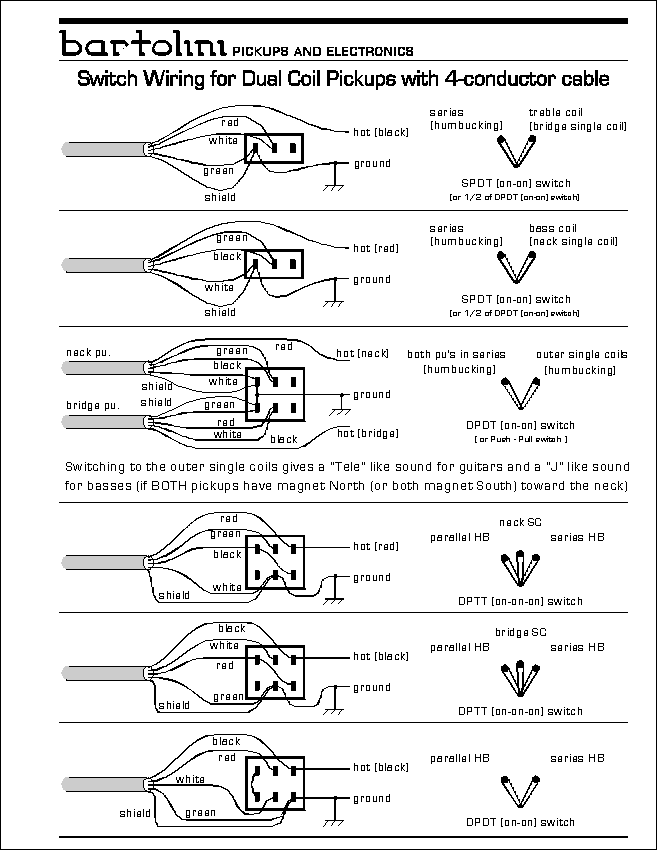

I've just got a Seymour Duncan MM alnico pup for a new bass (Warmoth, yum) and it has two coils, which can be wired in the following configurations:
1) Coil 1 only
2) Coil 2 only
3) Series
4) Parallel
Will there be any difference between 1 and 2? or are they so close that there's no difference?
Series vs. parallel: I know that series gives greater output, but apart from that how does the sound differ from parallel? Wiring in series puts inductance in series so that will reduce treble...is that the only reason for the 'thicker' sound? If so, surely there's not much point in using series wiring as it's easy to roll of treble elsewhere.
My proposed switching is one coil/parallel. I'm seeking opinions here, ie am I missing out by ignoring series wiring, or the differences between 1 and 2? Of course I could arrange a honking great 3P4W rotary switch for all four options but I'd rather just a 2 way mini toggle.

Parallel is the trad Stingray configuration.
Series will give more output than any other combination, and tends to emphasise the mids with less HF response.
Single coil is more Jazzlike, but the different winding config of an MM, and the placement of the pickup relative to the nut, means it'll be a bit more deep sounding, with the coil closest to the neck deeper than the other. However, I doubt you'll notice it on stage. Maybe not in the studio either depnding on lots of factors.
Check out the link in post 13 and read Ron's thread on MMs. In the J thread he messes with pickup placement of the Jazzes and doesn't hear any significant difference with moving 3/4" or so along the scale iirc.
I'd suggest a mini toggle on-on-on with a SC/Series/Parallel switching arrangement.
Attached is the Bartolini wiring diagram that shows how to wire it. You'll just need to transpose the SD colours. Wiring layouts 4 or 5.

Thanks, Brett. All pretty much as I thought, and yes I will put another pickup near the neck if I have to.
It does still look like there's no advantage to series wiring though (output is not an issue); the difference in tone is due to the series inductance, so I could get the same effect with eq elsewhere. Single/parallel seems to be the way to go.
Anyway, I'll temporarily put a bunch of DIP switches in the cavity to hear all the options for myself before I do anything drastic. I might even get round to posting samples...
