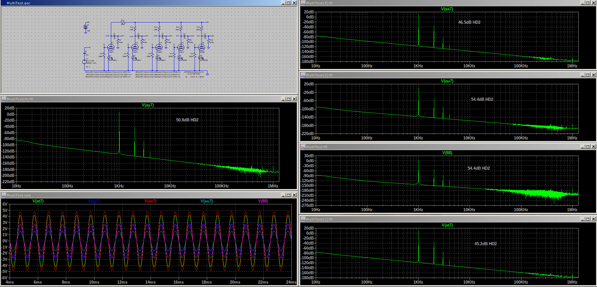

Just a couple of random thoughts. I would make sure that you do not use global FB because as was mentioned earlier it adds a real headache when using tubes with not only different gains but also different capacitances. If you used local FB in the VAS it would help but that adds another set of resistors that have to be "OK" for all.
Perhaps you could use an LED on the cathode and an adjustable active load on the plate. If the CCS was not adjustable you would have to use a current appropriate for the tube with the least current capacity.
Not surprised that the AX7 didn't do too well as 100K is pretty small load for it but kind of surprised how good the AU7 looked. Of course simulated HD is notoriously unreliable. You could have a switchable plate load pretty easily with one setting for the tubes that like a large plate resistor and another for those who prefer a smaller one.
P.S. Actually the HD for the AX7 was improved most by using a diode with less voltage drop.
