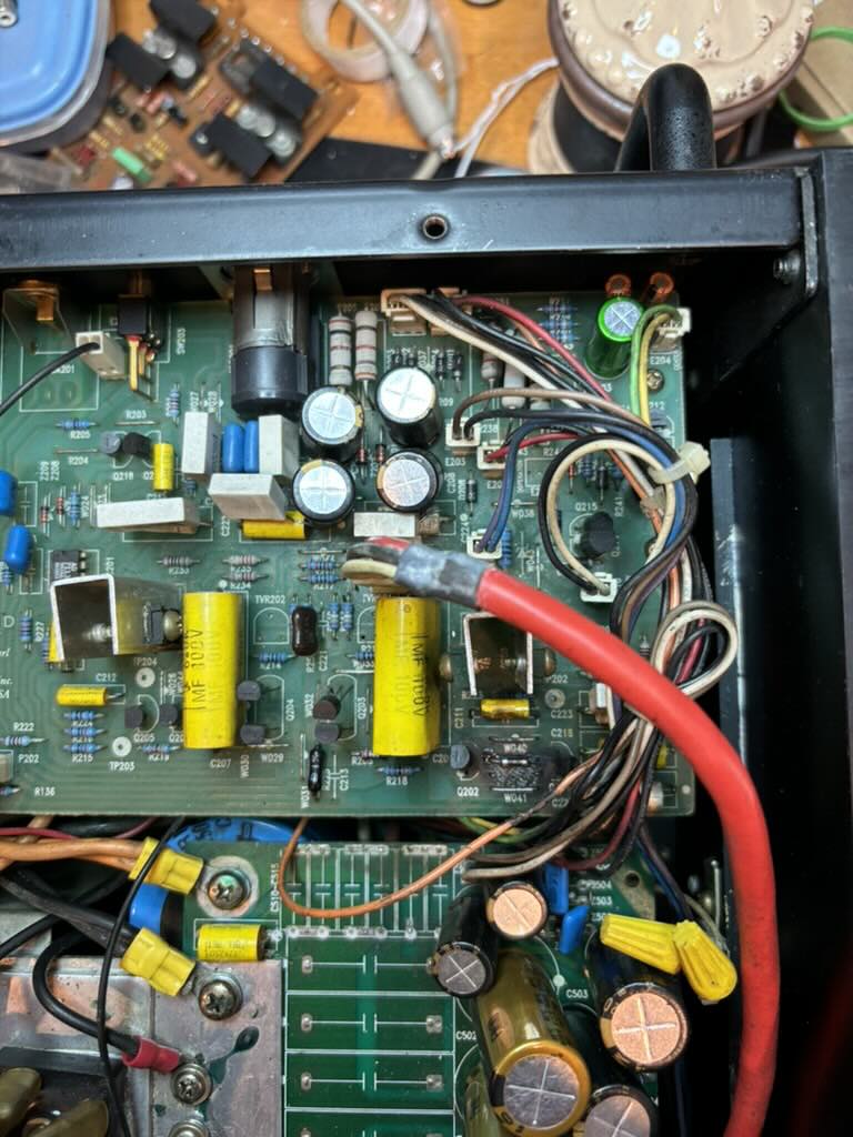

Now regarding all those film caps...........There is a guy in Greece that posted his mods to a 2200 II on the whatishifi blog but it seems to me that he quoted from John Curl for mods to both the 3500 and the 2200 II in his 2200II mod which has me just a little confused: There are a LOT of the white film capacitors in the 2200II. Some appear to be in parallel to other capacitors (board B1420) and not even specified in the schematic but most of them are actually in the original specs and there is even a place for those on the board (B1421). So I can see why the ones that are piggybacked in parallel onto other caps might can simply be cut out as being superfluous, but I wonder about all those on top.
On my unit in particular, it looks fantastic on the inside. There are no leaking caps or other repairs needed. So I am thinking of just replacing the R125 resistor and cutting out all those redundant film caps. These 2 mods seem fairly straightforward as long as I know which film caps I should be removing and which I should be removing and replacing with others.

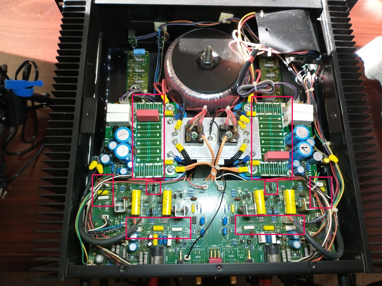

I have seen some mods from others where they have removed all of the film caps from the power boards (B1421 l/r) and did not replace them with anything - just left the boards empty. I have also seen where others have replaced them with 1 cap of the same total value as the ones removed and then I saw another mod where only 2 were left on the board. Then I read Big Sky Audio's upgrade mod sheet and they went a completely different direction and removed them all and replaced them with just 2 resistors!
Being a novice here I am guessing that the film caps have something to do with noise reduction and JC recommends removing most of them but what is the best course of action: Remove them all, remove only some (which ones?), replace with same total value?
Also, does anyone have an opinion as to why Big Sky Audio recommends replacing them with 2 resistors (YAGEO, ES 5.6 OHM 5% 2W AXIAL, metal oxide) instead of capacitors?

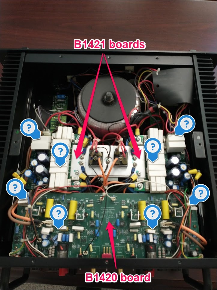

In case anyone else intends to modify their 2200II, I decided to follow John Curl's recommendations.
1. The "majority" of the film capacitors on the B1421 power boards (1421L and 1421R) can be removed.
I removed all caps from C510/C515(C610-C615), C516-C521(C616-C621) and C522-C527(C622-C627) - total of 24 caps with total capacitance of 1.02 K per channel..
I left C528(C628) and C529(C629) on the board - these 2 per board have a total capacitance of .44 K. I also left the 2 caps at C508-C509(C608-C609) on the board.
I installed 1 each Nichicon QXK series (1uF) film cap at C527 (C627).
Note that I have seen where others did not install anything - and I even saw where 1 mod done left C522 & C527 on the board.
2. Remove the "tacked on" or "paralleled" caps on the B1420 input board.
I removed all of the "tacked on" film caps on C117-C118 (C227-228), C122-C125 (C222-C225) - a total of 12 caps with total capacitance of .24 K
Note that I left all of the underlying cylindrical caps at these locations on the boards - I think this is what John Curl meant when he said "leave one at each board location".
3. The last suggestion that he had was to make sure the feedback resistors at R125(R225) are Resista or Holco "old". My 2200II appears to already have the old Holco installed from the factory. I saw a 1990s advertisement when Parasound was marketing this amp that said "Precision 1% tolerance Holco and Resista metal film resistors" were used so I am just guessing that at some point perhaps the factory starting to substitute other types? Hence the suggestion by JC to check this particular important one. It wouldn't surprise me that the factory did this - after seeing the fairly sloppy craftsmanship inside this particular amp.
So, if anyone is counting, I removed a total of 36 caps! Yikes.
Listening tests to follow and I have pics that I can post if anyone wants them.
