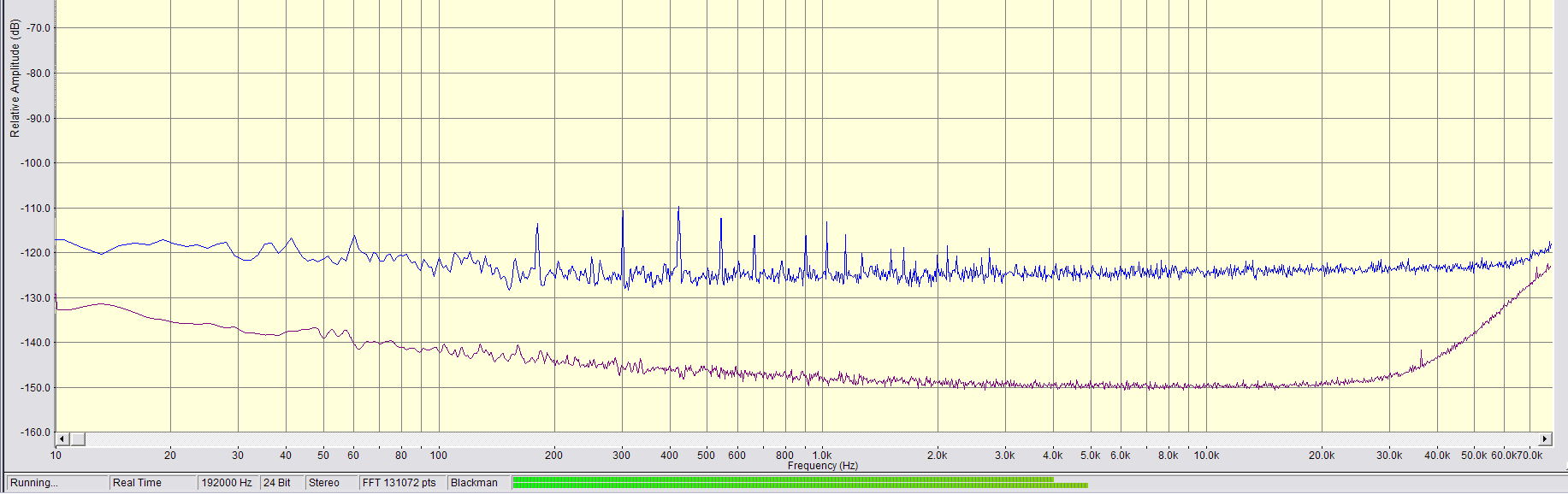

Do you use an oscilloscope or a measuring mic to measure the inherent 60/120hz hum from your amp? Without anything hooked up at the input, the output of the amp has a very small hum that is only audible if you put your ear up to the speaker. I'm trying to quantize the hum level and maybe do something about it (wire placement/isolation/etc), but my oscilloscope can't even trigger it.
Is a better way to measure this with a measuring mic? What is your technique?
You can measure it with the amp input shorted and a scope on the output.
You will need to put the scope on a low voltage range to pick it up enough to trigger the scope.

Yes that what I'm doing right now, my oscope can't seem to trigger noise that low. If i apply a signal (even a small one, like 50mV), it can trigger fine.

The trigger input selector on my scope has 3 positions, internal, external and line. If you switch the trigger input to line it should trigger on the 60Hz. You could always trigger on a second channel of your scope or the external trigger input connected to a low voltage AC transformer.
+1 I invested $200 odd in an emu sound card and fft software and have not looked back. I've reduced my system noise floor and distortion considerably by being able to measure changes in earthing, psu and bias setup.

Set timebase to around 2mS, set amplitude to minimum say 5mV/div, turn the trigger variable knob to come off "auto" to allow manual control of triggering.

Best is to FFT on a 24bit audio card so to see the spread of harmonic noise in spikes across the bands.

Best I can see with my 'scope is around 0.2 mV.
The attachments shows the output of a power amplifier, with a zero signal at the input.
The 60 Hz + harmonics peaks visible are 110 dB down (re.1 V).
This is about 3 uV.
The noise floor of the amplifier is better than 120 dB down, or about 1 uV.
The brown curve is the emu USB interface used for the measurements, wired in loop-back (basically the noise floor of the 'test equipment').
