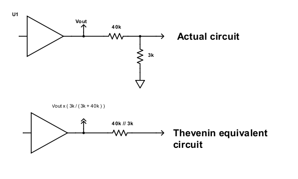

I am confused by the fact that in real circuit Zout is going down when the output signal is pulled to ground.
The resistor that you use to reduce the output voltage, is the reason that the net output impedance
reduces. The reduced output impedance results from the effect of the 3k resistor shunting the output.
If the 3k were in series, Zout would get larger, but since the 3k is connected in shunt, Zout gets smaller.
However, most circuits should not be heavily loaded, and their (unloaded) output impedance must be
much smaller than the load resistance that is connected to them.

But I am confused by the fact that in real circuit Zout is going down when the output signal is pulled to ground.
When you 'pull it to ground', you put a resistor from output to ground. This resistor is now in parallel with the original Zout, so naturally the parallel of the two is lower than the original. It has nothing to do with the actual signal level.
The drawing in post # 23 above shows this.
Jan
You need to think about what is the circuit you are measuring. Does it include the 3k3 resistor, or is that an external load on the circuit? There is not a right answer to this question, as it is your circuit so you can decide. You just need to be consistent.
That is a good point. If the 3.3k is part of the preamp, and if the connection is downstream to the load from there, it is reasonable to consider the 3.3k as part of the preamp and thus as part of the Zout.
If the 3.3k is NOT in the preamp but on the other side of the cable at the load, it is reasonable NOT to consider it part of Zout, but part of the load.
Jan
No matter how you set your controls or what you drive them with, you **ALWAYS** have 3k3 in parallel with the output connector/cable so your outoput impedance IS 3k3 in parallel with the generator impedance.
In this case the generator is the Preamp and its output impedance is high, (what was calculated above by others) so your output impedance, the one which is driving the output cable and the load at the other end, IS "a little less than 3k3".
