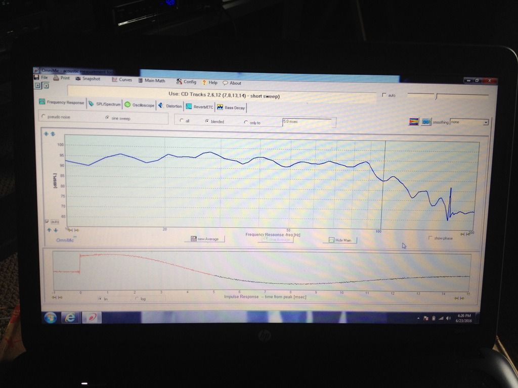

Thoughts on measuring my four subs from the LP. Here's how they measured
I would like to see how they measure from the LP so im not taxing the system too much.. So, im interested in distortion testing, i like the FR though..

Measuring distortion of subs indoors can be difficult. The problem is that to avoid the measurement being too fouled by room reflections and modes, you have to have the microphone up very close to the sub driver. But then, you can't test at too high a level since the microphone is easily overdriven when that close (and when playing at the usually very high subwoofer levels). You can easily end up measuring the distortion of an overdriven mic capsule.
With OmniMic, you want to keep the level at the mic below about 115dBSPL (varies from mic-to-mic, other electret-based mics will be similar). Just use the OmniMic distortion measurement tab-page and put the mic up within about an inch of the woofer (assuming a sealed sub). ***BTW, if you're in Micropsoft Vista or later, make sure that the OM is seen by the system as "2-channel, 48kHz" mode (the OS defaults all USB mics to mono, which can make the OM levels read very wrong!); and run OmniMic software in WindowsXP SP3 emulation mode (as with Windows 8 or later, Microsoft changed the way mic sensitivity settings get interpreted, which can also make the levels read very wrong -- a new version 5 of OM software should be released very soon, that internally fixes this second issue).
If measuring outside, put the woofer away from all large surfaces except the ground and put the mic on the ground at some distance from the woofer. Then you can play the woofer louder, but that's still not an easy solution, because outside, a woofer an any drive level won't cause nearly as high SPL as it will be indoors. No room reinforcement happens outside -- which can be a lot for subwoofers.

You can't totally discriminate if the values are similar. But if the measurement comes out as a few tenths of a percent, you can be pretty sure it isn't really whole percentages, since the distortion is unlikely to cancel that much (or at all for 3rd harmonic). There will always be a resolution floor to any measurement, you can only ever verify that the result isn't much worse than your test gear.
You can also measure at different levels and see how distortion increases with level. If distortion is from a single contributor, then (at levels well above background noise anyway), 2nd harmonic level will tend to increase 2dB for each 1dB increase in drive. 3rd will tend toward 3dB per 1dB increase. If that behavior is seen, then likely the distortion is dominated by just the speaker (or by just the microphone if you're nearing its limits - you can move the mic away to reduce the SPL it sees and see if the distortion changes with its level).
OmniMics, BTW, are individually calibrated for amplitude, not one-fits-all. Admittedly with some roadbumps along the way (but I think those are ironed out now).
