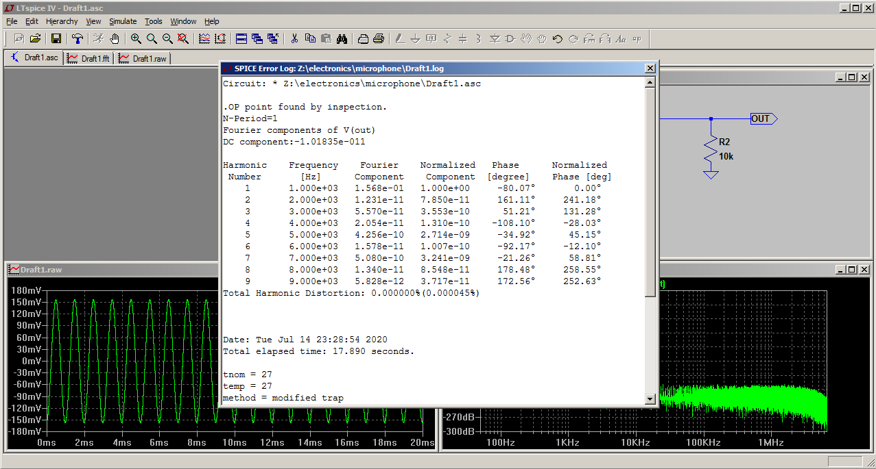

I followed the instructions given by Mooly precisely identical, I get this.
Hayk

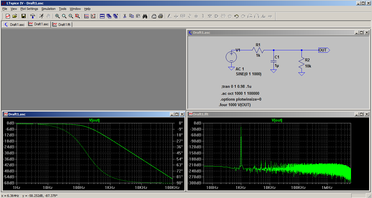

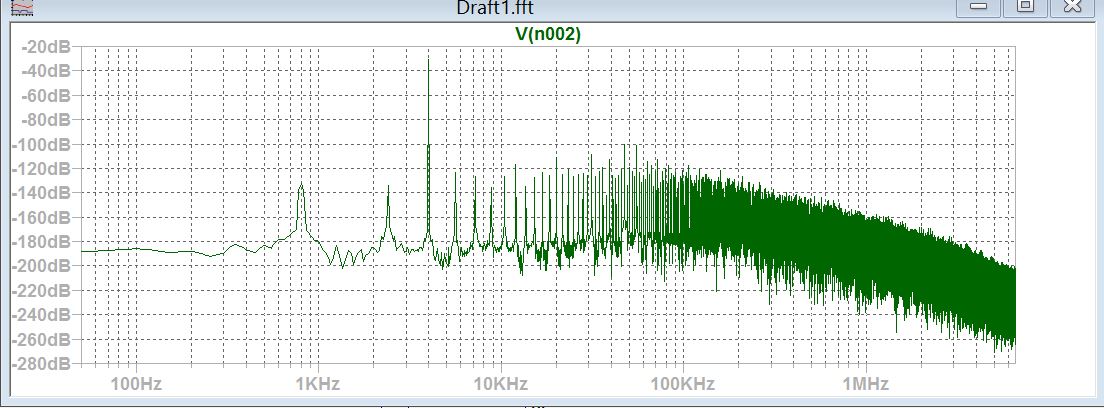

Perhaps if you actually showed us the circuit that you are simulating? In general LTspice will give you much lower distortion than what you would get in real life. So I would be concerned about the circuit that is producing that result 😉
Tony.
Tony.
It is the same circuit without 10k. The last measurement I followed the instruction at 4khz. When I look your FFT , sure, I am not doing what should.

Even without the 10K resistor the result is pretty much the same. Take out the .options plotwinsize=0 however and it starts to look more ugly.
I don't know why you have the drooping noise floor though...
Tony.
Tony.

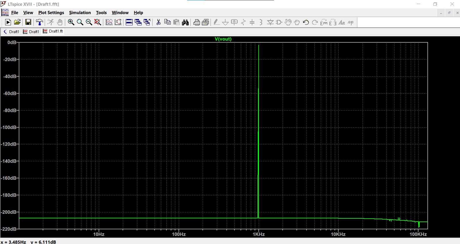

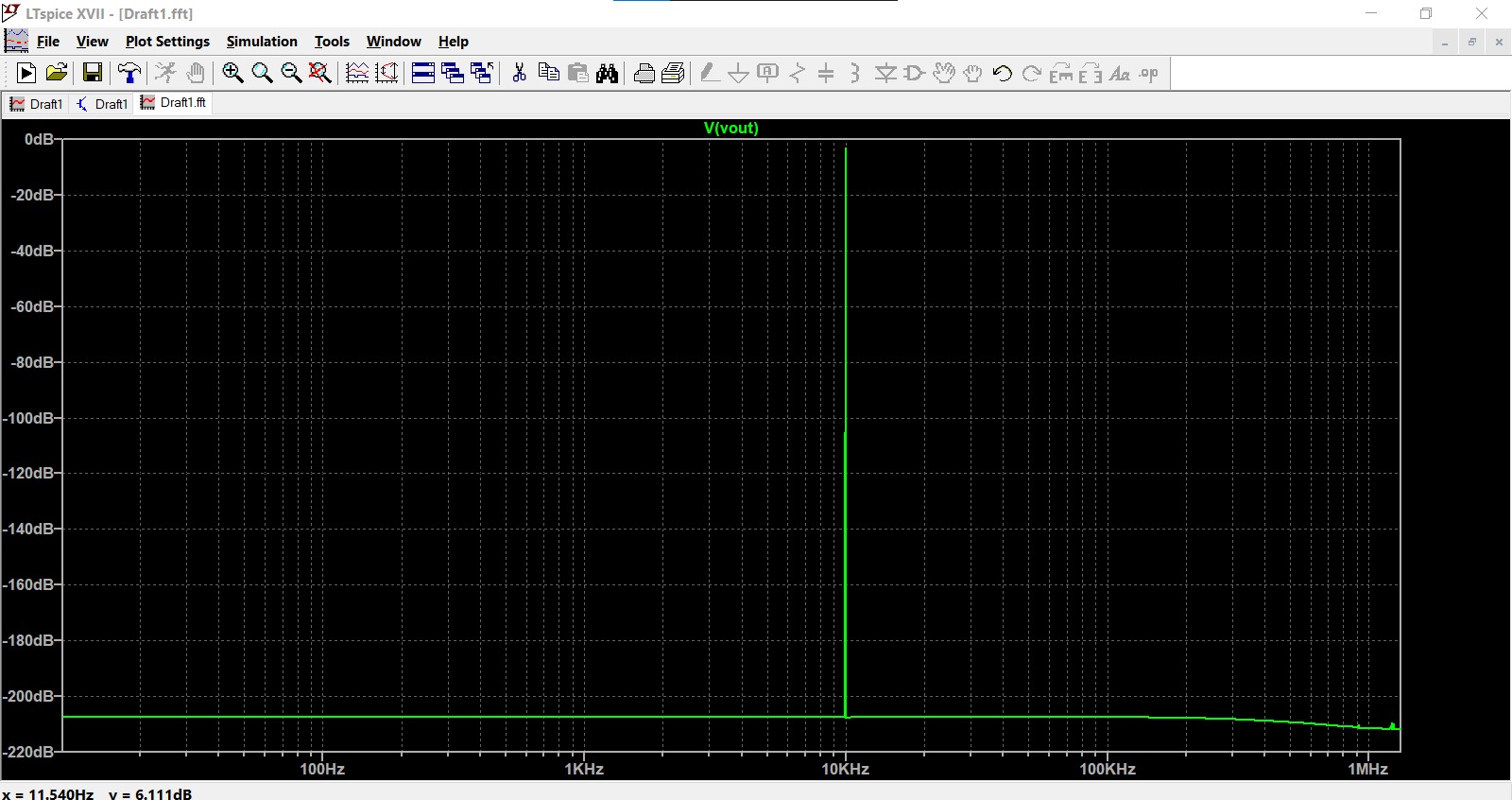

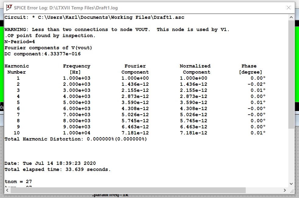

Can you give your way of adjusting the simulation/FFT as Mooly does. I am sure many other members will be also thankful.
Hayk
Hayk

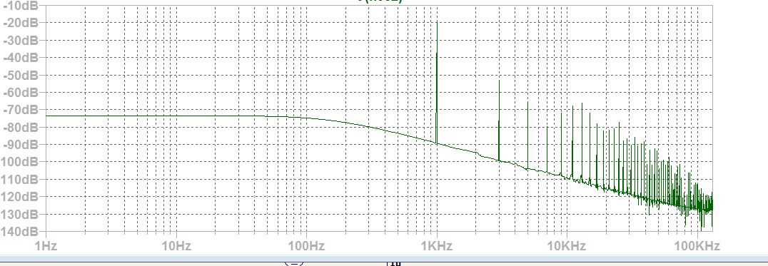

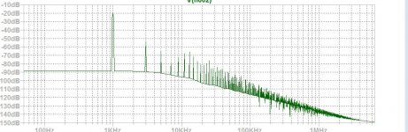

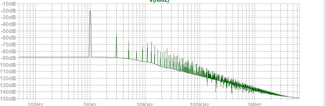

Here is an ultra low distortion FFT at 1kHz and 10kHz.

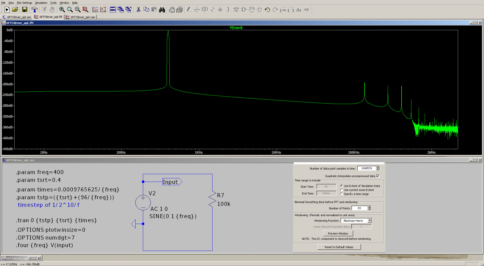

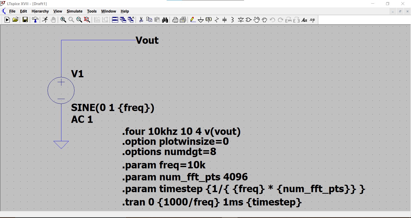

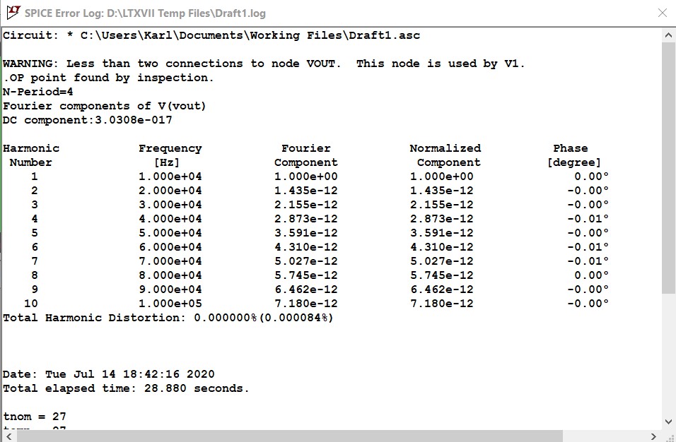

The attached works well here. Normal operation is to only adjust parameters:
freq = oscillator frequency
tsrt = time top start data capture
Note the oscillator frequency is locked to {freq}. The rest automatically calculates time step and simulation stop time against frequency based on reasoning long forgotten. The results are close enough for government work. The Spice error log for 'input' looks like:
Total Harmonic Distortion: 0.000000%(0.000000%)
