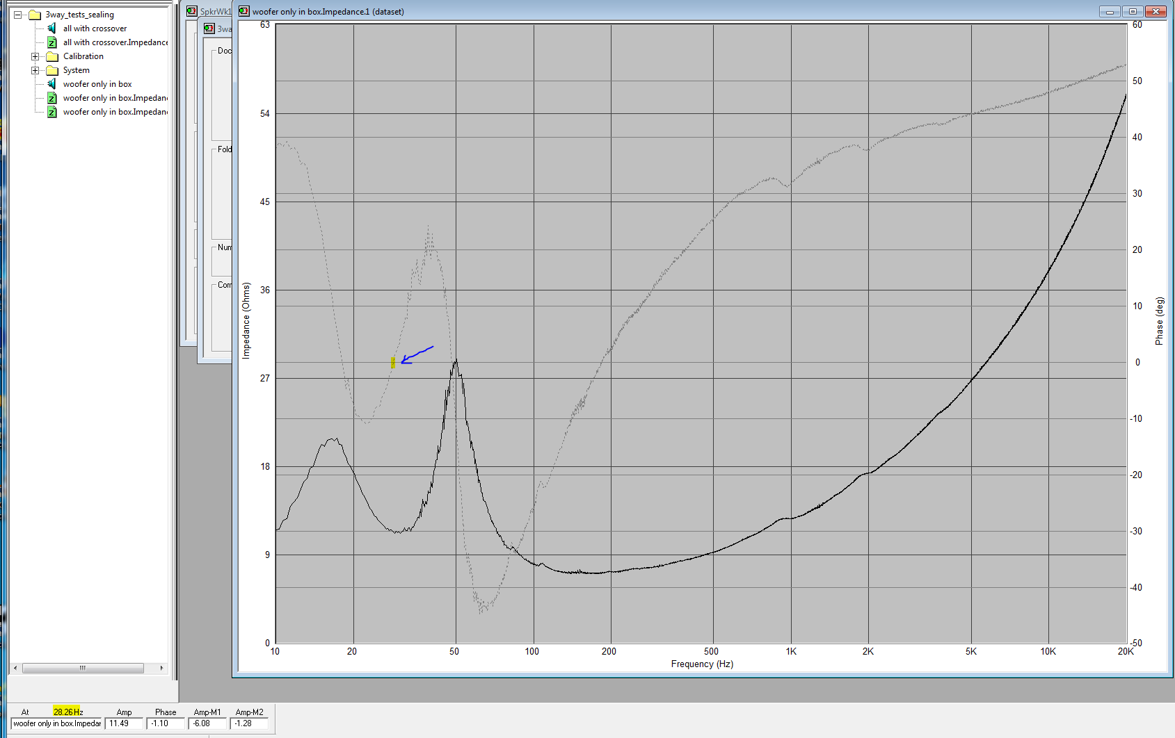

I've attached an example of using impedance measurement to determine the port tuning.
You want to look for the phase zero crossing between the two impedance peaks. In this case ~28Hz. This should also be roughly half way between the two impedance peaks.

Okay, the responses that I am getting here clearly indicate that I am well out of my depth 🙂
I had no idea that electrical impedance would come into it, have never looked at impedance measures before, don't know what phase zero crossings are, and had thought that a simple acoustic measurement would confirm whether port tuning was correct.
Is there any reasonably condensed reading that you could direct me to, in order to get my head around this stuff?
At this rate... I don't even have any ability to take measures of electrical impedance against frequency.

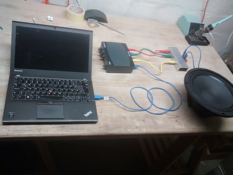

I like impedance measurements for their simplicity producing reliable results.
You are not the first one to encounter big differences between theory and practical measurements. One reason (out of a bunch) are beautified T/S parameters given by the vendors - with the free open air fs resonance the most prominent. The surrounding is stiffer than predicted. In case of a B&C 10HPL51 woofer I measured fs=72Hz - contrary to fs=55Hz specified.
As a rule of thumb I found that real fq-response most of the time ends at higher tuning frequencies than simulation predicts.
