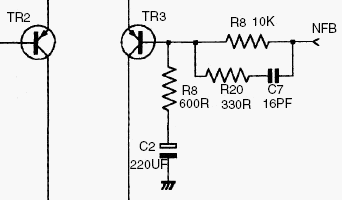

I wonder because some use other compensation beyond the Cdom, with a capacitor or RC filter in resistor NFB.
Would be to reduce the action the second and perhaps third pole?
Yes, the circuit you have shown is lead compensation in the feedback path. It is used to advantage by some to help cancel the phase lag effects of extra poles in the forward path of the amplifier. It can also mitigate the effect of the pole formed at the summing node between the feedback netowrk resistance and the input capacitance of the LTP. However, caution is required in using lead compensation in the faeedback path because it can eat into gain margin and also provide a better path for EMI ingress from the output of the amplifier back to the input stage. The use of a resistor in series with the lead capacitor, as you have shown, helps reduce this concern.
I also regularly employ a small resistor in series with Cdom in the forward path to help counteract the effects of parasitic poles. Once again, this should be used with caustion, as it can eat into gain margin.
