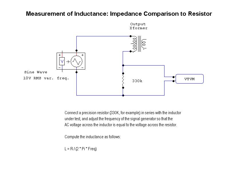

Whichever method or meter is used to determine inductance, the result must be accompanied with the test's excitation voltage condition, and also preferably the test frequency. Jazbo's link tests at 5VAC. Using a typical 5VAC heater supply and a current meter also tests at 5VAC. Some manufacturers use a higher excitation voltage, possibly to 'enhance' the inductance value.
Many general purpose LCR meters, especially handheld modern ones, are likely to use a relatively low excitation voltage, and hence measured inductance will be substantially lower than normally reported.
The Hammond data that Ian gave earlier is a little ambiguous as to what the primary voltage value means - it could be the excitation voltage used for the inductance value test - but I have some doubt.

Yep the primary voltages in that list are the AC voltages required for rated output power - not the voltage that the primary inductance was measure at.

It appears that you still do not know how to measure the OPT's, please see gingertube's post above, do you see what you are missing?
Sure , Ill do that . Thanks for the advice.
See post#4 for method
http://www.diyaudio.com/forums/tube...roper-way-measure-transformer-inductance.html

You measured low inductance with low voltage because the B-H curve (permeability) is not linear, the permeability is low when the excitation current is low. By increasing the current, there is a relatively long relatively linear section, and around the saturation the magnetic field again does not increase linearly.the question is not how to measure at this point , the question is why off the shelf OT have low inductance . Perhaps if we can get more measurements of guitar amp OTs we can make a conclusion.
Since the inductance is proportional to the relative permeability that is non-linear, the inductance itself depends on the measuring current.
It does not matter whether you measure the primary (with higher current) or the secondary (with lower current), and in most cases measuring the secondary in the order of 10s of Volts is more convenient. You can use the formule Lpri = n^2 * Lsec
