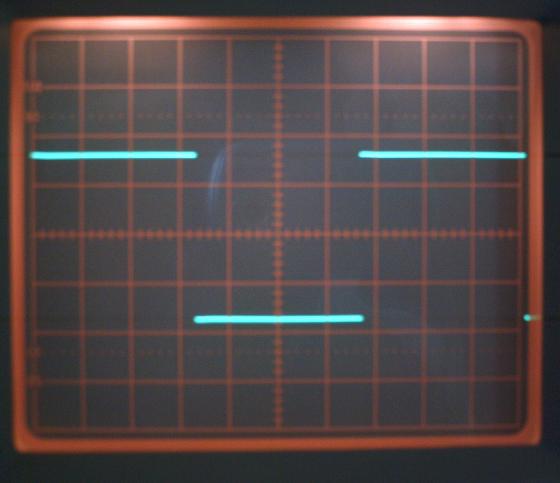

I do not have any multimeter with frequency measurement.
I managed to get the 1 kHz square wave from the Sheffield Test CD. This time I am using an older Sony CD player that I bought for $2.0 in a jumble sale years ago instead of the DVD player.
Volts/DIV is set at 0.2
SEC/DIV is set at 2ms
See picure below
See picure below

Thats it ! You will see your squarewave looks identical to the one I posted, slow risetimes and ringing from the filters in the player.
Now you have a 'scope I think a function or signal generator would be next on the shopping list. I have attached another image, this is a squarewave from a function generator. Notice how fast the rise time are compared to the CD. This is really the sort of signal you need for measuring amps etc, but having said that try your test disc squarewave through an amp. The function generator I use covers from 0.1 hz to 2 Mhz sine/square and triangle waveforms with a max output of around 7 volts RMS.
You mentioned at the start about checking your amp. The only point to watch is as I mentioned earlier, that if the 'scope is connected to mains earth then the probe earth becomes a "shorting link", to anything referenced to earth. That does not read well does it ! If your JLH psu ground is also connected to mains earth, then touching the probe earth to say the positive rail will apply a dead short across it. If in any doubt measure on DC then AC volts between the points you want to apply the ground wire first.

Hi Karl,
Measured across the emitter resistors (100m) after 20 minutes warm up.
Bottom half
For Q1 R14 ---> 49 mV
For Q1a R16 ---> 85 mV
Top half
For Q2 R13 ---> 37 mV
For Q2a R15 ---> 96 mV
The DC voltage of emitter of Q4 is 605 mV
DC offset stable around -6 mV at speaker outputs
The emitter of Q2a and speaker Vout is 100 mV
DC Supply rails +26.7 V and -26.7 V at C6 and C7
