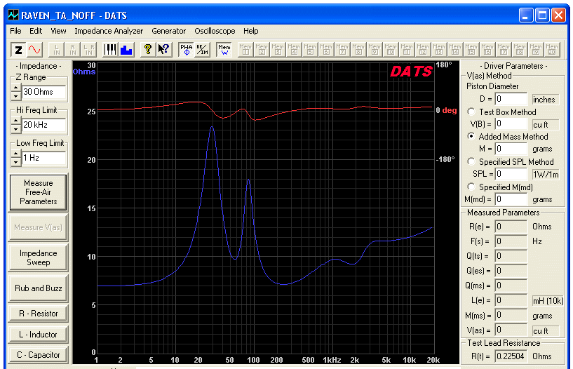

I put together a pair of 3 way speakers from left over parts. Xsim told me the system impedance would be mostly 8 ohms but the DC resistance of the system measures 11 ohms. Is there a way to measure the actual impedance of the system? I have a DATS V2. All the drivers are rated at 8 ohms.
REW (Roome EQ Wizard) has a section that outlines how to make impedance measurements. Its been a while but it boils down to a box with a resistor connected to your speaker, run a sweep and you'll get an impedance plot.
I thought the DATS was only to be used on the driver that is not hooked up to anything else. I want to test the system.
So to be clear, you just hook the DATS leads to the speaker box input terminals? With the drivers wired up to the crossover? And then do a sweep?
Yes.
Sounds to me like something is miswired in series. "8 ohms" would be about 5-6 ohms DC resistance, and 5.5x2=11. Trace your wiring really carefully, and measure the DCR of each driver.DC resistance of the system measures 11 ohms...ll the drivers are rated at 8 ohms.
An impedance sweep is the first thing I do to make sure I have the crossover wired up correctly and avoid frying my output transistors. This is especially useful for a 20+ part 3 way crossover
