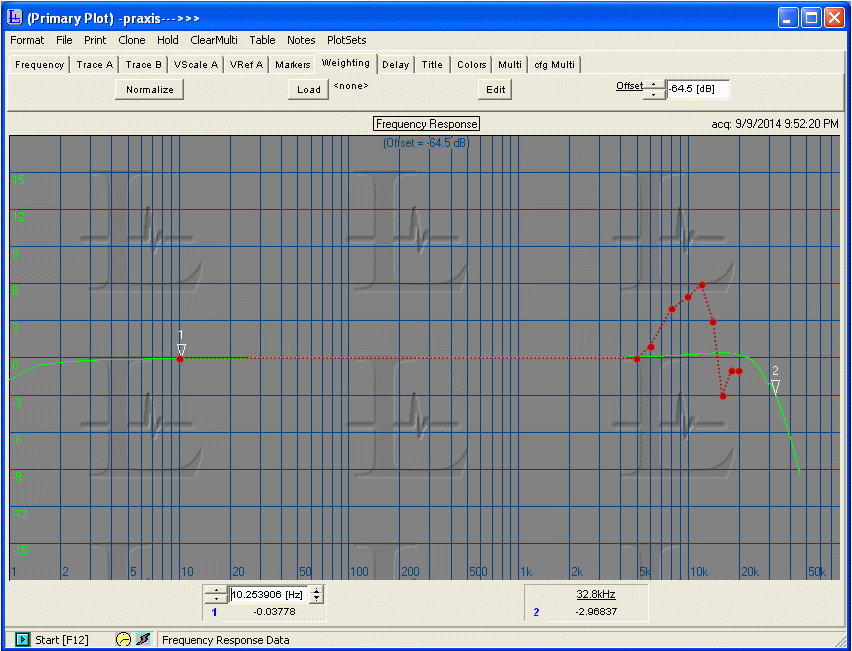

Here's data for ESL transformer fans, DW with flat input. Ratio is a hair under 1:100. Output measured at around 150 vac rms.
Flat from 10 Hz (no kidding) to around 5 kHz. About 5 dB eak around 12 kHz.

Here's data for ESL transformer fans, DW with flat input. Ratio is a hair under 1:100. Output measured at around 150 vac rms. Flat from 10 Hz (no kidding) to around 5 kHz. About 5 dB eak around 12 kHz.
Now that looks more like a transformer should. Nicely done. :up:
Did you get a chance to measure the Thordarson that drives the tweeter array? What did you do different this time from when you were measuring the 3db/oct slope in the response? Was the DW transformer driving the ESL at the time you made this latest measurement? If not, the 12kHz resonance peak and start of HF roll off will move down in frequency once the panels are connected. This resonance could be damped a bit with low value resistance in series with the primary. The one DW schematic I have seen shows a 2.7 ohm.
http://www.diyaudio.com/forums/planars-exotics/205136-ground-reference-esls-2.html#post2886152
For grins, I plotted your data in red on top of a recent measurement of my ESL transformer(step-up ratio = 1:140).
It is driving my segmented stator ESL and has a 2 ohm damping resistance in series with the primary.

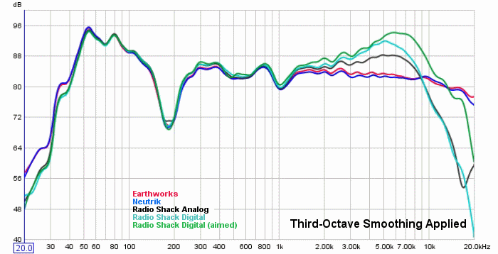

You mentioned previously that some of your measurement were taken using a Radio Shack SPL meter microphone. I know you also mentioned using some calibration data, but I recently stumbled on some comparisons with the RS mic and its HF roll if did appear similar to what you were showing. Perhaps it is part of the answer to your question about the falling top octave response you were seeing when measuring your ESL tweeter panels.

Ummm, looks like I should have tossed my Radio Shack analog SPL meter long ago. Results with Dayton EMM-6 vastly nicer than RS north of 8 kHz. (Took a week or so on Toronto Kijiji to get a phantom supply for mic, but there are lots of Behringer mixers out there for sale if you are hesitating buying an electret mic, as I did. Or need something for karaoke. They seem durable enough for our purposes second-hand and performance OK for measurement purposes (which paradoxically aren't as stringent as they would be for listening). Xenyx 1204 for c$70.)

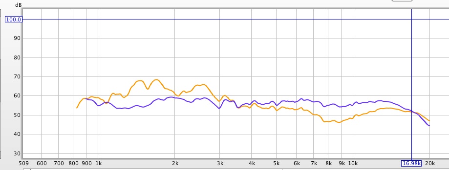

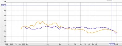

But purely for scientific interest (and to boast a bit), the curve below in orange is the sound at my chair (about 70 inches from the tweeters) with the EMM-6 mic, flat signal to tweeter interface box, just the Dennesen tweeters playing full-range. The blue curve includes the Dayton-Wright mid-range (with crossover around 2.8 kHz) and the DSP EQ I've been using the past few months, 1/12 smoothing. Ahem, ahem, roughly keeps +/- 3 dB, 900-16,000 (on a good day).

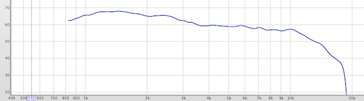

FRESH DATA

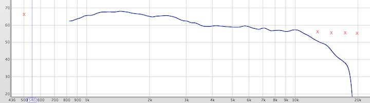

I tested the output of my interface (Thordarson transformer and associated components). I connected an AC VTVM to the plates of my tweeter array (bias off) and fed a flat sweep. The output curve, at about 80 vrms (similar to music playing) with the 4 cells of the array connected was essentially flat from 20 Hz to 1 kHz and then it looked as close as could be to the sound output curve below! I hesitate to affirm too strongly that this is a proper way to measure the transformer output.. may not be.

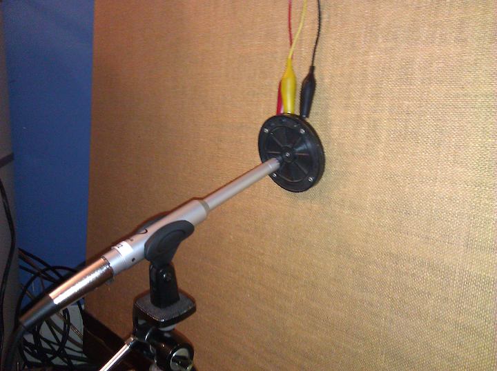

Then, bias back on, I tested a single cell (manufacturer is Dennesen) at one inch; the 4 cells of the array were also playing but at a relatively great distance away (3 feet which was about 20 dB below the single cell by sound measurement). See photo and resulting curve.
(Apparently, the curves for the curved array presented earlier actually did somewhat resemble the signal... now that I can see how the signal from the interface falls off above 1 kHz. Now I'll try to run some better curves for the curved array and post them.)
So, a single Dennesen cell will reproduce the freq response of the input signal really closely and to high frequencies.
Ben

In the attached chart, I've added some X's to show how the electrical output of the step-up interface differs from the sound output of a single cell, repeating the chart posted in the previous entry. The two curves are similar 1 kHz to maybe 11 kHz. They differ at the high end although my measurements may be less reliable there.
Ben
