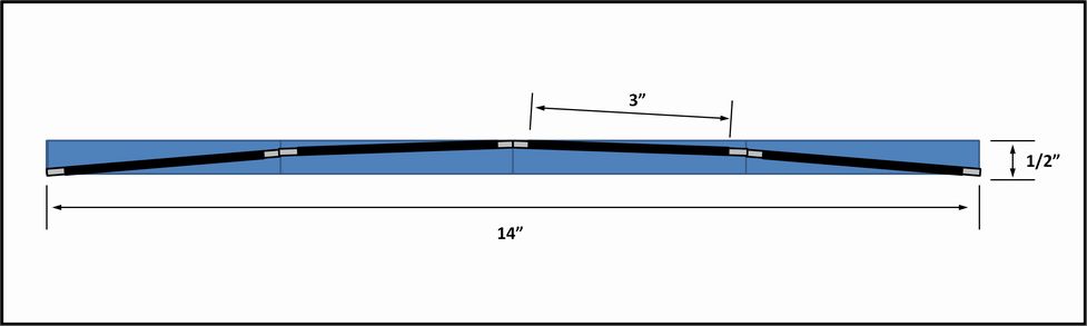

To illustrate, in my array pictured below, there are 4 circular ESL panels mounted on a curved articulated surface. the two outer panels are roughly a half-inch further from any point in the direction the array is facing. While the treble sound is dramatically wonderful on treble percussion (and measurement of a single ESL in isolation is as swell as I'd want and with dispersion a lot wider than the panel angle), the listening position measurement of the whole array in action gets horrible north of maybe 7 kHz.
Thanks.
Ben

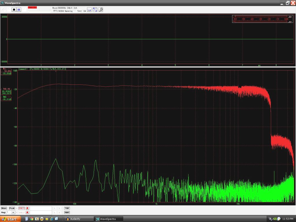

One of the easiest ways I do such measurements is by feeding the system with some noise and use a RTA program to see the response in realtime as I move the microphone around.
This method is quicker than moving the microphone and waiting for the sweep test to finish each time.
I use either Visual Analyzer or a program called WaveSpectra for this, there are a few other ones available as well but I forget their names at this time.
Wave spectra seems to be one of the best to use as it gives you a scope display as well.
It is very fast and doesn't glitch as it operates in realtime!
Not to mention that it can be set in a 24bit mode too. 😉
Wave spectra can be found here and it is Free,

Hmmm......I didn't know REW did a true RTA I will have to take a look at it a little closer.
But do get Wave Spectra I am very sure you will be very happy with that utility as well.
It does peaks as well as continuing with the RTA.
Here is a sample shot that I did of an FR sweep that I did on my Tape deck (MSR16)using it.
There wasn't any waveform displayed on the scope trace because it was after the playback sweep was done, but the noise floor was still realtime when I made this screen capture. 🙂
jer 🙂

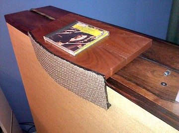

… Back of 3-inch ESL disks has some damping paper. Not much influence from the rear the way I have them sitting draped over the Dayton-Wright boxes - as judged by the absence of change when I stuff hi-tech absorbent behind them.
I have always found placing ESLs just in front of other objects whether designed to be acoustically absorbent or not tend to result in reflections that propagate back thru the ESL and combined with the forward firing wavefront resulting in periodic peaks and valleys in the response. Does this look at all like what you saw? Can you post the data file or response graph of what you are measuring at the listening position?
I posted an example measurement showing the effect of placing a section of fiberglass damping behind an ESL here:
http://www.diyaudio.com/forums/planars-exotics/178916-esl-acoustic-foam-2.html#post2401844

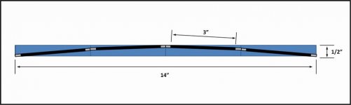

I'd guess. the tweeter speaker is a 14 x 4.5 inch, segmented curve. The peak distance from a chord between the ends makes the middle two drivers about .5 inch closer to my ears than the outer two.
Does the attached figure approximate your ESL array?
If so, I can simulate the polar response to see what interference effects you might expect from the array spacing and angles.

Yes, that sketch is accurate. It would be good to see the geometric/acoustic modeling, when you have the spare time.

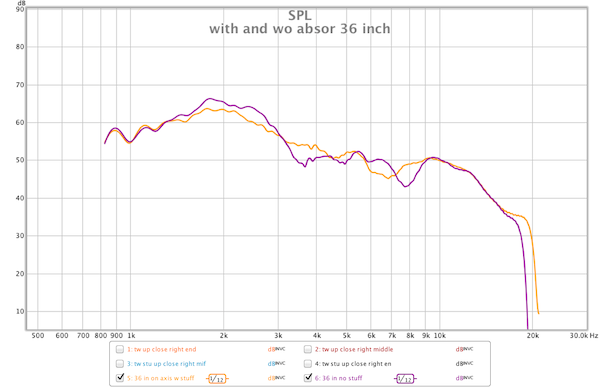

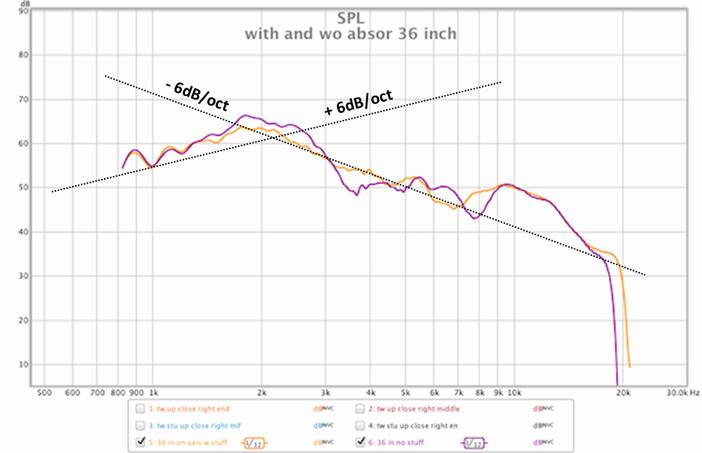

Below is a freq response at 36 inches of the tweeter array, on axis. The orange trace is with a bundle of commercial absorbent behind the array. The set-up, angles, distances, etc. may be a bit discrepant between the traces. And for sure, my ancient Radio Shack SPL meter with a large electret is not good for higher frequencies, even with the web-endorsed calibration correction plugged into REW.
Never the less, there seems to be some impact of the absorbent, albeit not with any interpretable regularity that I can discern.
All I can now declare about my free-air up-close tests of a single tweeter element (and using a gen-U-ine Dayton-Wright cosmos-class transformer and different HV bias) is that, at the time and mental state I was in, the result for these little Dennesen guys seemed amazingly flat and extended. I'll try to test some again.
About measured sound versus heard sound, I believe there are differences, but based on psycho-acoustics not mythical powers. For equivalent mic response in a certain part of the music compass, a room with more reverb in that band will sound different - including possibly the perception of loudness. For sure, the dipole adherents like their sound and probably could prove they can tell it apart in an ABX blind test, even if the freq response was matched by mic. Such an experiment is inconceivable, of course. And not sure what kind of a blind test it would be if you couldn't "match" reverb.... which is the point of the test.

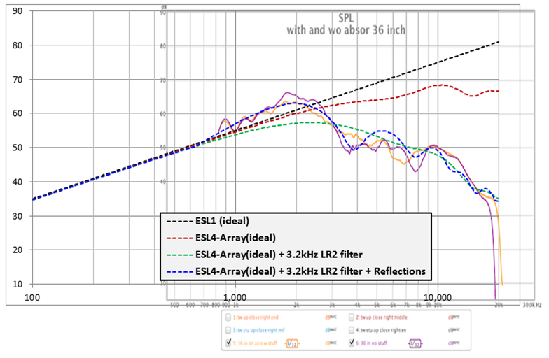

You caught me at a good time as I have been working on a spreadsheet to calculate polar response for curved ESLs(ie Martin Logan) and faceted arcs(ie SoundLab).
Based on your comment in the post#1 "...the listening position measurement of the whole array in action gets horrible north of maybe 7 kHz..." I was expecting a very "messy" response; hence my comments in post#7. What is it above 7kHz that you feel suddenly gets worse than below 7kHz?
The measurement did make me scratch my head for a while. Usually small ESLs measured at a distance slope upward at +6dB/oct til the top octave where diaphragm mass/stator transparency/transformer response tilt it downward. However, your response shows a downward -6dB/oct slope over most of the frequency range. (See attachment #1) Is it possible you had a 2nd order LP crossover active when you took the measurements? Perhaps at 3.2kHz as mentioned in your signature line?
Attachment #2 overlays a rough "first cut" estimate of the response a few degrees off axis at your measurement distance.
Black dashed line = response for a single ideal ESL panel
Red dashed line = response for a curved array of 4 ideal ESL panel
Green dashed line = adds the effect of a 3.2kHz LR2 low-pass filter
Blue dashed line = adds an estimated effect of partial reflections from about 1.75" behind the array
Until I understand why your array has that downward tilt I won't be able to predict it's polar response properly.
In the overlay, I assumed it was just due to a LP filter.

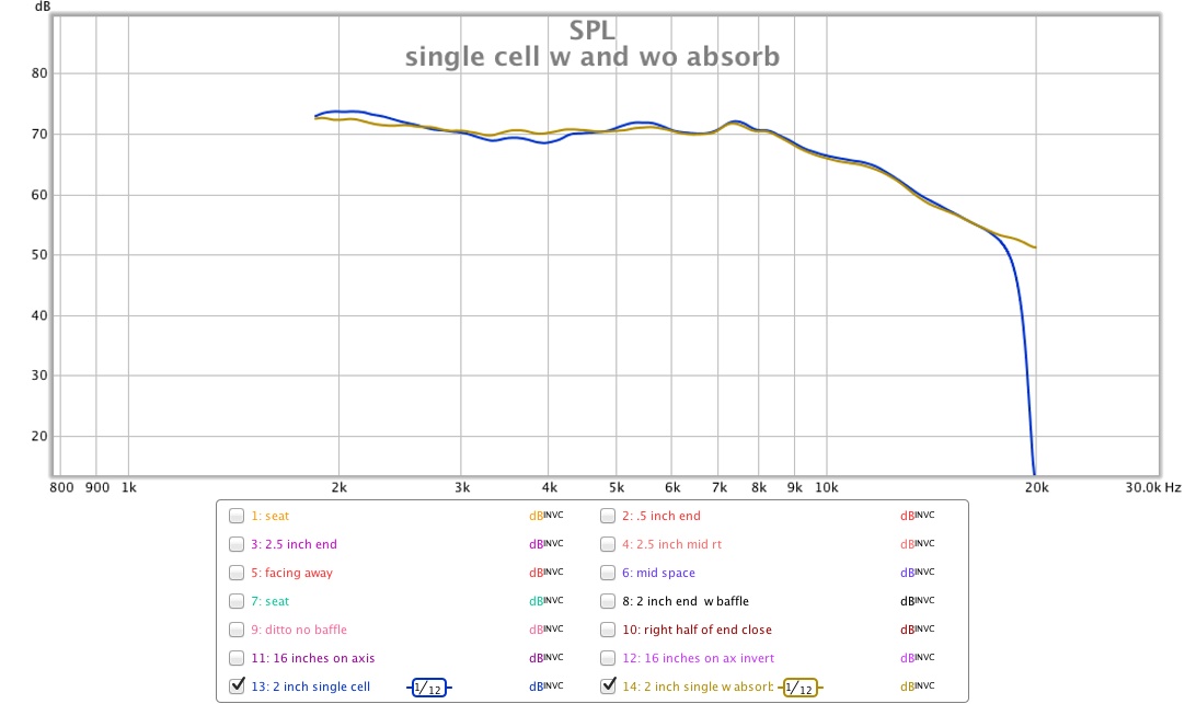

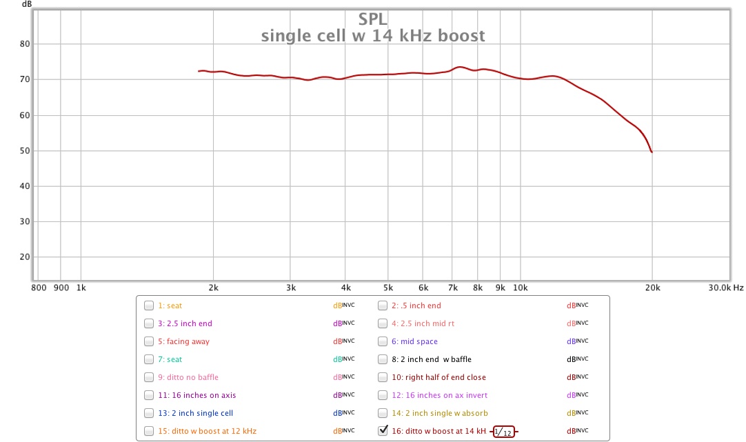

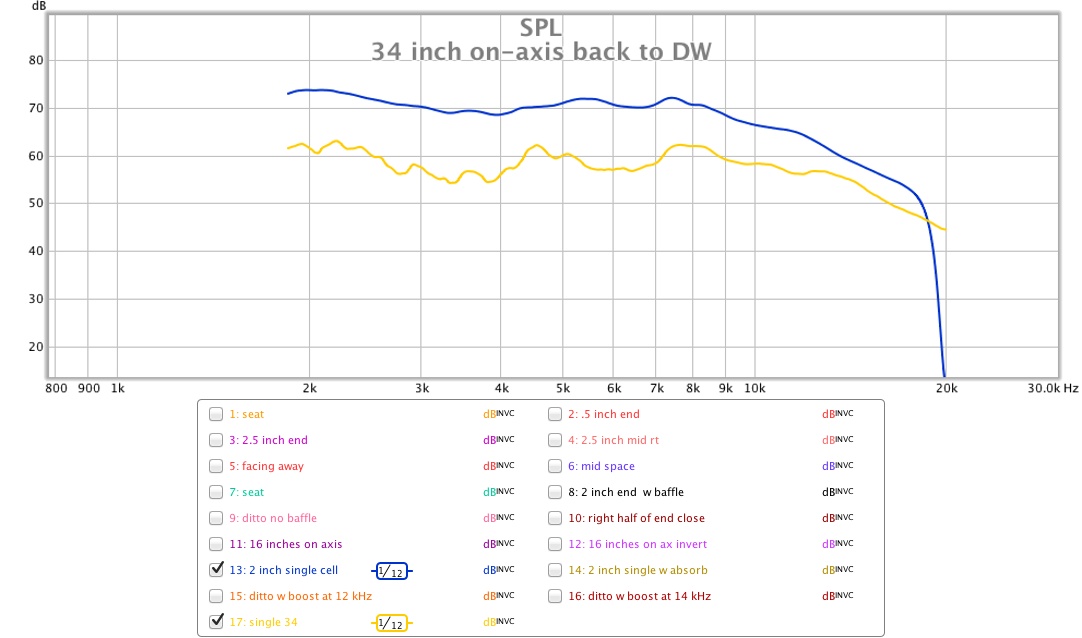

Here are two measurements of a single cell hanging in the air in front of the Dayton-Wright speakers. 1/12 averaging... not sure about other REW parameters.
The brown is with commercial absorbent behind to mop up some rear output. That's a pretty nice curve and what I'd like from my array. Droop from 8 kHz might be from Thordarson 6V6 tube output transformer used for step-up and whatever other bits I might have in-between for whatever reason 25 yrs ago.
The blue is without the absorbent, showing the usual dip at 3 - 4 kHz from rear wave or adjacent cell cancellation.
The second chart shows what you can do with a digital signal processor boosting at 14 kHz. Roughly plus and minus 3 dB from 1800 to 14 kHz. Nice, eh. At least for today's mic runs. Don't ask where my elderly hearing ends or why I need that boost. BTW, that's the boost I use for music listening with the array (but of course not for most test runs).
Ben
Nice set of measurements. :up:

Orange trace is a single cell at 34 inches. Back of cell to DW. (Some tiny ripples from array also playing and other differences in height off carpet, etc.) Blue trace is previously posted non-absorbent 2 inch run.
Sure looks good and a lot better than array in post #10 (or at my chair) measured comparably. So I am still wondering why full array at 74 inches to my ear in a stuffed Lazy-Boy chair doesn't look as good?
Ben
Unlikely that drive signal to cells is pooping out at high frequencies.
After much contemplation, all I did was connect my 60 yr old Heathkit AC VTVM ("VT" means vacuum tube)* directly to the output of the step-up transformer (with the array connected but no HV...). Prolly about 150 kOhm input impedance, sort of.
The signal drops quite orderly about 3 dB per octave from 4 kHz up. About the same response when connected to a DW transformer with no array connected.
Hard to say how meaningful is this measurement. But I'd say it likely means the signal to the tweeter array doesn't track the high freq droop.
