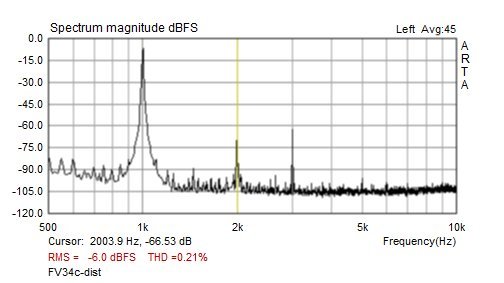

I am not so concerned with precise calibration of ARTA.
This is how I do it:
Adjust the PC output to give the suitable volume to the amp.
Use the ARTA Spectrum analyser (SPA) to see if there is any signs of noticable distortion above a certain volum level of PC ouput level. Use a DVM to measure the amp output level.
Set the PC input level to give a level at least 3 dB below the 0dB level (clipping). Observe the spectrum analyser again to see if the harmonics increase with to high volume.
For quick measurements select the Arta Impulse Response mode (Imp), and then select the smoothed FR window, and run a test using sine sweep. This gives a quick FR curve in 2 seconds, but not distortion. I prefer to use the Spectrum analyser for distortion analysis.
The STEP program used for your plots does not use a continous sweep, but steps of tones. This could explain the small ripple. I have only used this for speaker measurements, and thus never been concerned with ripple of less than a dB.
SveinB
PS. Here is a distortion spectrum of my EL84PP amp.
SveinB
