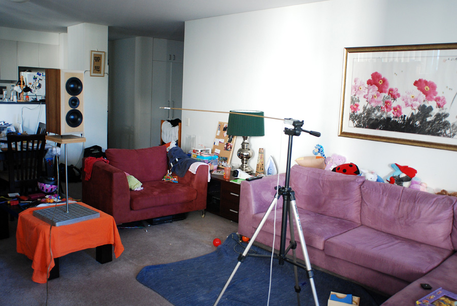

Speaker and mic above ground

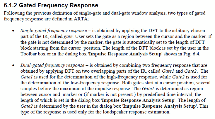

OK... so what do you call the process of "selecting" a certain portion of the impulse response (the part without reflections, aka the direct sound)?
-Charlie
Hello Charlie
It's not up to me to tell the developers what term to use. ARTA uses Start and End markers for their IR and calls them "Gates". The resulting FR within these markers (Gates) is therefore a "Gated Frequency Response".
I disagree with them because of methodology. A Gated measurement is derived from a specific process of obtaining measurements. To say it's a Gated Frequency Response when that process is not adhered to causes confusion. The OmniMic that I have does the same thing as ARTA. They avoided using this term in their GUI and user manual.
Let me put it another way.
If I were to list in my restaurant menu a "magnificently marbled Ribeye Steak GRILLED to perfection" and what I served to the customer is a Ribeye that's PANFRIED, he has the right to reject it. Both are cooked but the method of cooking is very different.
Which measurement system does that?
The one I'm using is LMS. There may be others that I'm not aware off.

I have successfully done indoors measurements down to about 300Hz, below that is difficult in a typical house.
Try to get as far away from walls/objects as you can and preferably angle a bit across the room (so you are not exactly parallel or perpendicular to the walls).

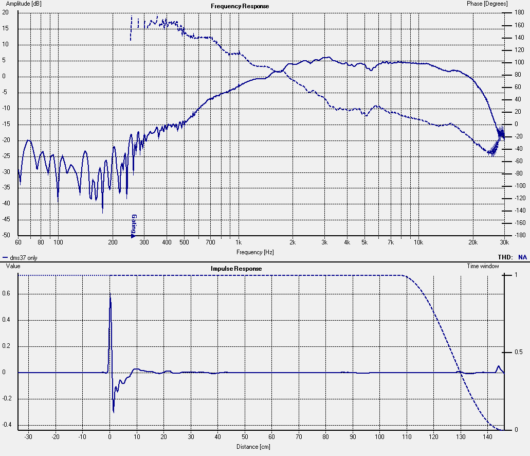

Attached is a measurement of a morel DMS37 tweeter done at 1M Room size was about 4.5M X 7M with about 2.5M ceiling. second picture was taken of the measurement setup at the time of this measurement.
I'd also second SY's recommendation to get Joe D'appolito's book. I have it, but unfortuately I don't think I got (or I lost) the CD.
For desiging a two way speaker I'd say that in room measurements provided done properly (and you can get consistent results) should be more than adequate.
Note that the gating on that measurement should be set slightly lower than what it is in the attached picture, you can see the ripple in the high frequencies as a result of including the bump just before 130CM.
