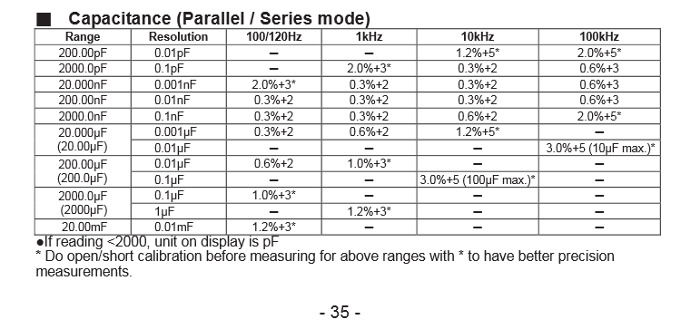

how to measure 10.000uF
How to measure 10.000uF 63V capacitors?
My DVM can't have enough range😡
TIA

By the way between others I also have a UNI-T UT139C DMM with a good range of features, reasonable build quality and protection for the price too, that can reach 100000uF.
~35 Euro on Ebay from mainland China or ~50 Euro from European stockists. Maybe its also useful info to you while the methods the other guys mentioned are valid and handy.
