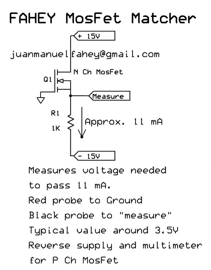

I'm not sure if the mosfets are died yet but just incase they are i would like to know how to match them with inexpensive equipment.
they are IRFP240

Try the Fahey MOSFET Matcher 😉:
https://www.diyaudio.com/community/...p8n10-and-mtp8p10-mosfets.391097/post-7157977
And yes, you need a simple +/-15V power supply.

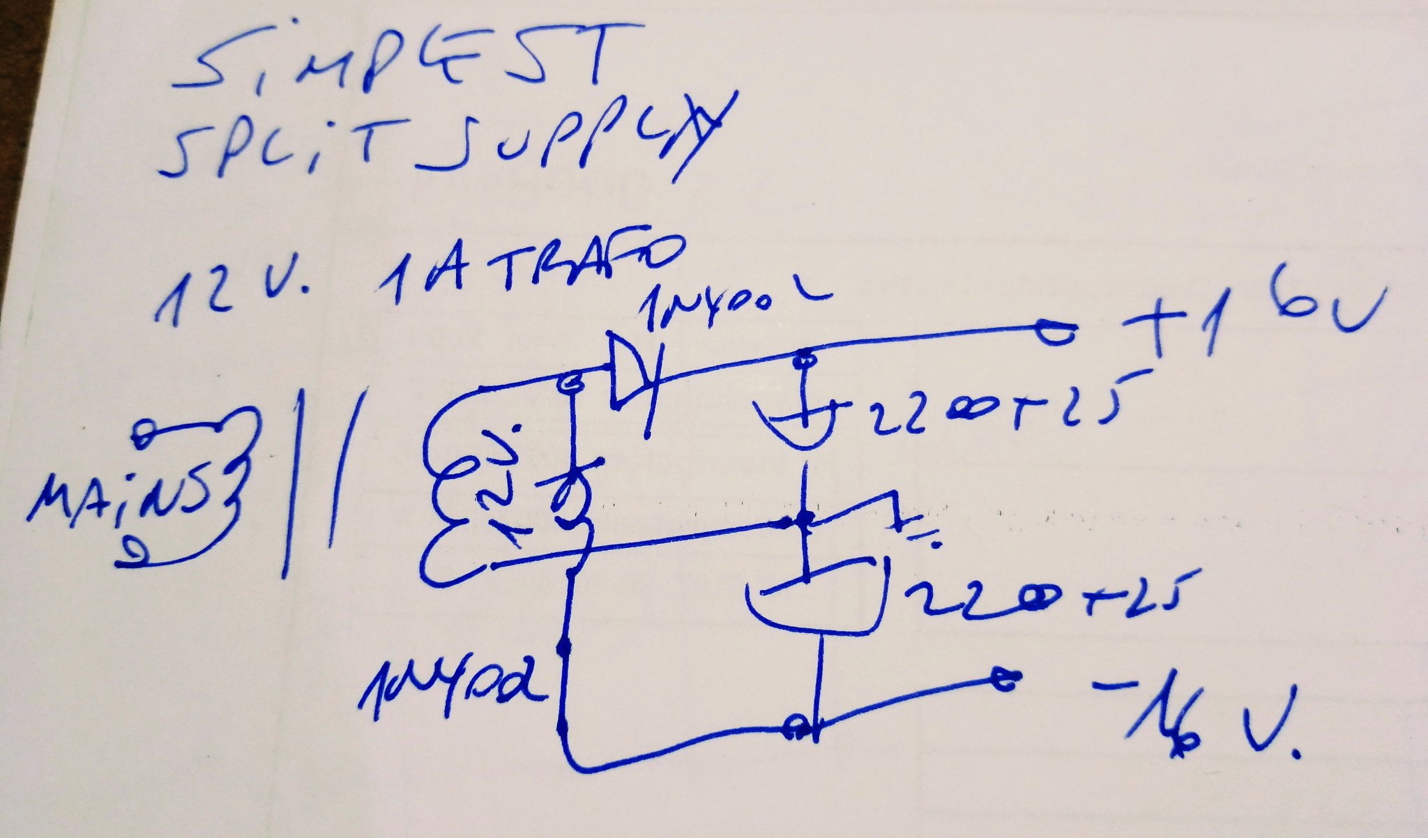

Easy peasy, simplest needs one 12V transformer, 2 1N4002 diodes and 2 2200uFx25V caps

To the best of my knowledge there is not a ready-made device that can do power MOSFETs under the conditions of their normal use (or close to it). There may be one... I just don't know of it. You need to match under the conditions of use (or get close) or it's not terribly valid.
The other thing to consider is... what are you matching for and why... and what circuit is it going into? The article shows how to check for Vgs(th). There are a lot of other parameters that might be important.

The IRFP240 current will depend on whether the amp is running Class A or AB. If class A, the quiescent current will be around 1ampDC or so. So for the mosfet test circuit in post #5 above with a 12VDC supply, the resistor R1 will need to be something like 10 ohm 20watts, this will enable you to measure Vgs at a current of around 1 amp, provided your PSU can deliver that.
If the amp is class AB then the device current will likely be around 100mA or so - then the resistor needs to be 100 ohm at 2 watts.
You don't need a +/- supply - +12vDC and Gnd will be fine. Read the FW article linked in post #2.

I'm looking at that first watt page and the diagram is blurry does anyone know were i can find a better diagrams for setting it up?
just to make sure I'm on the same page, i need to pick the ones with the same or closest to each other.
do i need to use the formula or just go off by the readout in volts?

Above 5V or so drain current is almost a constant, so no need to test at full rail voltage.
To each his own, but I am happy matching at or near bias current.
At higher currents, ballast resistor drop swamps any minor Vgs difference.
Think 1 to 3 V swamping a few mV difference.
Also found that MosFets matched at 11mA still track very well at 100mA, but of course to each his own 🙂

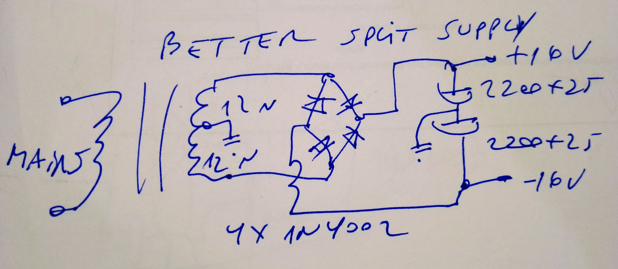

Raw +/- 16V supplies, good enough for MosFet matching.
Transformer: cheap 12 or 12+12 VAC, 200-500 mA. Even 1 A won't hurt.
Really, the idea is to order nothing, but kludge these using junk box stuff.
Doesn't hurt but isn't really needed either to add some regulation, down to +/-12V or +/-9 VDC.
