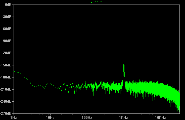

Hi Ray. Here are a couple more suggestions to help generate clean FFT plots. Turning off data compression has already been mentioned. It's crucial, as is ensuring the simulation time (or the selected time window for FFT) capture a waveform starting and ending at zero crossings.
In the FFT menu is a parameter window labeled "Number of data point samples in time". I usually set it to 65536. In the schematic half under "Edit Simulation Command" > Transient, set Timeslice to the reciprocal of the number of data point samples selected for FFT, in this case 1/65536 or 0.0000152587890625. I'm not familiar with the relative benefits of different windowing functions but have been told by pros in the field that Blackman is the way to go so typically leave it at that.
One caveat. LTSpice appears to have an oddity regarding data caching. Sometimes making these changes mid-session results in unusual FFT plots, for example large spikes above 100 kHz. Closing and restarting the session always clears it. As a sanity check I set the signal source as ideal - no output impedance or parasitics - and run an FFT on it to insure it's 'perfect'. When correct it looks like graph below.

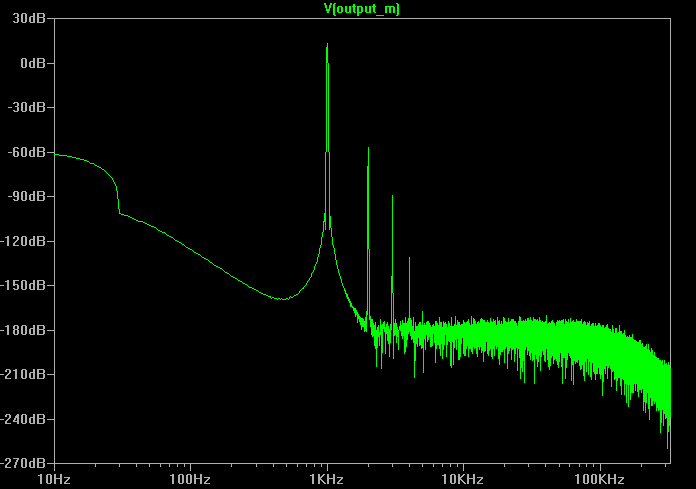

Long runs before data capture begins allow 'the circuit' to stabilize. Not all require it. The graphs posted earlier - a simple LED biased, choke loaded, R-coupled two 12at7 circuit - was based on a 200 msec total run, from 0-100 msec for warmup and data captured from 100 to 200 msec with a 1000 Hz source. Obviously, that works out to 100 full cycles at 1000 Hz (but only 10 at 100 Hz.)
As another sanity check the same sim as above was run under identical conditions except 1 sec was added to both parameters. Capture began at 1100 msec and ended at 1200 msec. In this case 100 msec of warmup is apparently plenty for computational accuracy well exceeding that of the tube model, the distrotion harmonics were unaffected.

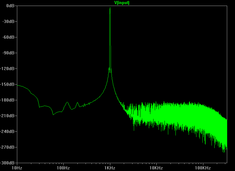

Long capture periods are great for improving resolution and low frequency accuracy, though it's a judgement call if the additional information is useful. The sim above was altered to capture a full second of data after the same 1100 msec of warm up. The input spectrum is shown below.

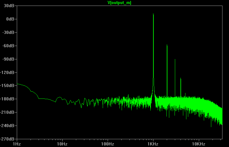

And the output here. Certainly the skirts are much tighter and the low frequency accuracy greatly improved. It's questionable if the added computational time gains any useful information, the harmonics haven't changed noticably.
Also, sorry for not being clear earlier. I run the FFT on the full captured waveform: "Use Extent of Simulation Data". The FFT period is in effect fully set by the .tran directive.
